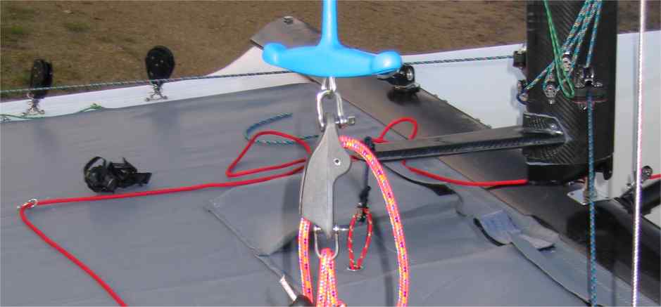

Scooby, where do you mount your second set of spinnaker blocks? The auto-ratchets are at the ends of the main beam.
And what about the boards? Apparently JP says its alright to leave them down at all times but I felt they were tripping the boat a bit downhill.

Dave,
I have 2 ratchamatics on each hull and run the Spi thru both of them:
180 defree turn thru the aft one, then about 150deg thru the forward one and then to hand.  I've taken the springs off since this picture was taken.
As for plates, I leave mine fully down to about 12 kts and then bring them up a little as the wind goes up.  But I do have monster long plates!!!

Thanks Scooby. Both your ratchets are further aft than on the one I sailed. Also your spanner is at mast-foot whereas "mine" (don't get any ideas - I haven't got the money or the inclination at the mo) is just below the boom. There's something different about the downhaul as well - I'll compare you photo with the boat next time I am at the club - which will be this afternoon to put an extra rope round my Hurri - storms are coming to NI.
Red line is spinnaker halyard?
PM me with more pics if convenient. This boat is essentially set up as a double hander and the owner far prefers his Spitfire so doesn't spend much time on tuning the Stealth.

Dave
A lot has changed on my boat setup since that picture was taken!
I need to take some more pics, but will not be at the club for a couple of weeks as I am off to throw myself down mountains at great speed with planks on my feet.
yes, in that pic, red is Spi halyard.  mast spanner setup has changed as well, as I now have a setup similar to the Shadow for fine tune and a setup to allow me to let it all off for downwind.
My boat is optimised for single handing.
