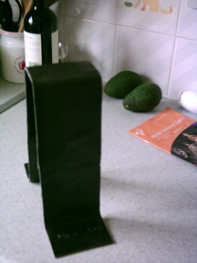

Post Options Post Options   Quote Garry Quote  Post ReplyReply Direct Link To This Post Posted: 22 Apr 06 at 2:05pm
Strong carboard box used to make up template. Plastic sheet taped over it so resin wouldn't stick.
2 layers 170 gsm carbon laid up at 45 degrees. Two layers of some CSM I had lyinging about and then 4 layers of carbon laid up with the weave running up/down. Used plastic sheet and block to squeeze out excess resin. Allowed to go off and then hacksaw used to cut off rough edges. Just need to grind chamfer on edges, drill holes and fit.

Thanks to everyone for their help and advice. Nearly finished project is below.
