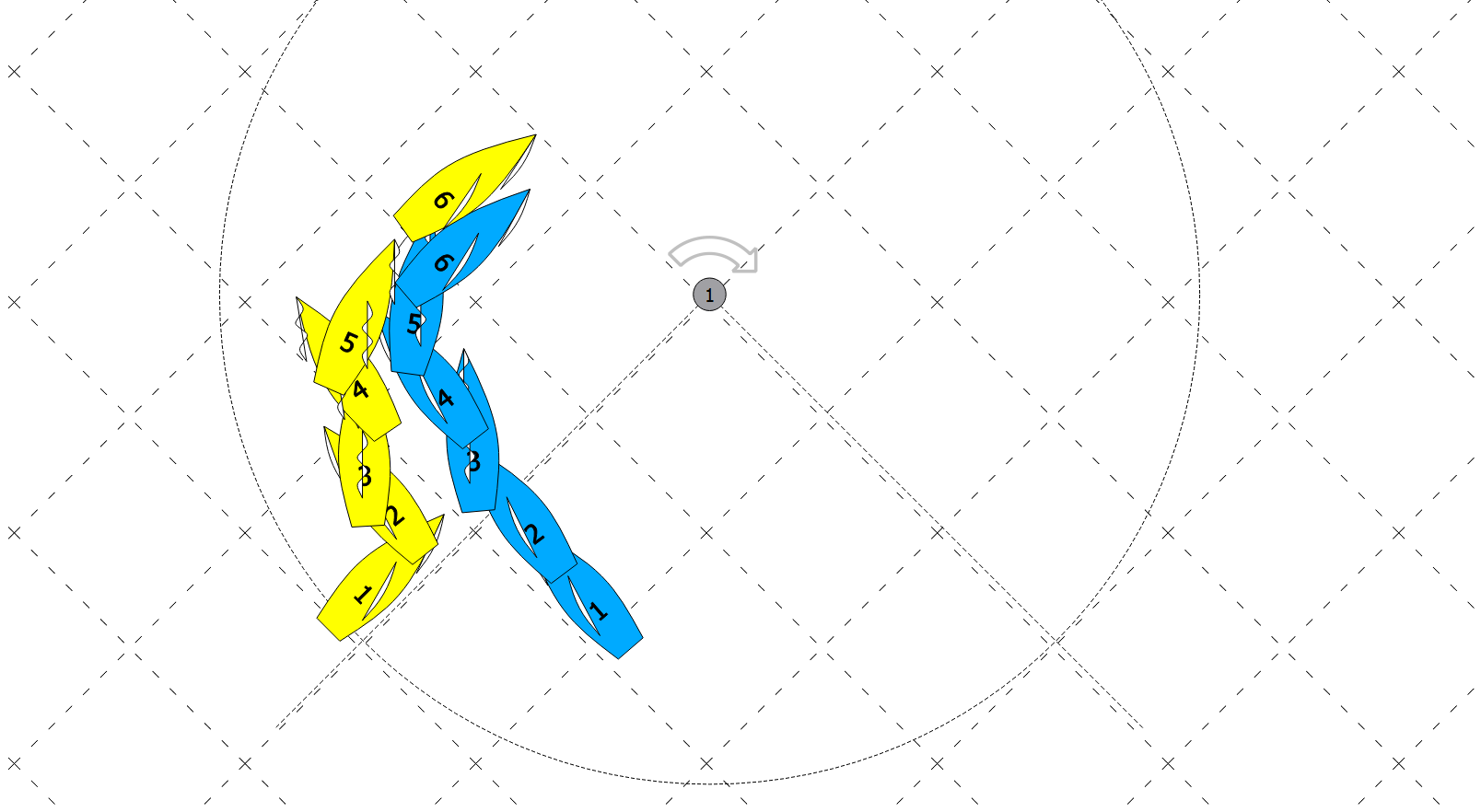

Your scenarios goes through quite a few stages where the rules may apply differently, so lets break them up, using a diagram Y, Yellow, You, B, Blue Him.

Today I was upwind on what I hoped was the port layline approx 3 lengths from the mark. I had to give way to a starboard tack boat heading for the same mark, I tacked under and was then the leeward boat and 1/2 a length ahead.
@1 and @2 in the diagram.

As JimC has described, up to here, Y is right of way boat, but B is entitled to mark-room, which, from 2 BL away from the mark is room to sail to the mark (Definitions: Mark-Room (a)).
If you really are both past the layline (and are able to convince a protest committee of that), then B is sailing away from the mark, not sailing to the mark, not sailing within the mark-room to which she is entitled and therefore will not be exonerated under rule 21 if she fails to keep clear of Y.
Y is exposed if she uses this aggressively: a protest committee might apply the last point of certainty, namely that B was NOT above the layline, and conclude that she was sailing to the mark, within her mark-room and entitled to exoneration. If Y luffs, bears away to avoid contact, and protests, this is a win/don't win protest for Y, so she can do that with safety, but if there is contact, it becomes a win/lose protest with Y at risk of penalty if she loses the protest.

After I tacked under and was leeward I did luff up hoping to make H tack. We were still about two lengths from the mark and I was sure we had gone beyond the layline. H didn't tack so I straightened up.
@3 and @4 in the diagram.
Originally posted by epicfail
After that it's a bit hard to describe accurately. We both ended up eventually tacking to port well after the time I considered sensible.
@5 in the diagram.
Boats are in the zone, on same tack, B overlapped inside, rules 18.2(b) not applying so B is entitled to mark-room to sail to the mark, which she is doing (by changing course to do so), and B will be exonerated if she breaks a right of way rule, or rule 15 or 16 (rule 21).

H had trouble completing the tack for some reason (shifty wind near an island of trees) I'm now the windward boat happy to go for the mark only to find H inside me having a struggle to get through the tack. I put a hand out to keep the boats apart. All very slow motion.
If B had not yet reached her close hauled course when contact occurred, she was required to keep clear (rule 13), but is exonerated for that breach because she was sailing within the mark-room to which she was entitled.
If B had reached her close hauled course when contact occurred, then she was leeward right of way boat, and it is Y, overlapped to windward, that has failed to keep clear and broken rule 11.
There was contact. Even though there was no damage or injury and a boat may be exonerated under rule 14(b), we must consider rule 14.
I think that Y could have avoided contact throughout: there was nothing (except a massive tactical disadvantage) to stop her from sailing higher and giving B a wider berth. Y did not avoid contact with B when it was reasonably possible to do so. Y broke rule 14.
If the contact occurred before B reached her close hauled course (and was required to keep clear under rule 13), Y, the right of way boat shall be exonerated for breaking rule 14 (rule 14(b)).
If contact occurred after B reached her close hauled course, then Y is neither the right of way boat nor entitled to room, and is thus not exonerated for breaking rule 14.
I don't think B could have done anything to avoid contact once Y was coming down on her. B did not break rule 14. If this is wrong, and she could have avoided contact, she was a boat entitled to mark-room, and is exonerated for breaking rule 14 under rule 14(b).
