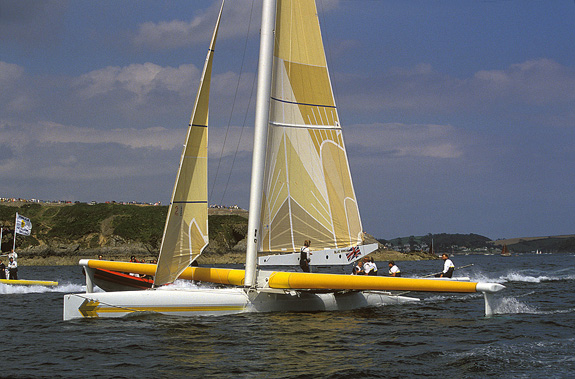

Ever since I read about how lift-to-drag ratios are so high in ground effect Lyft I have dreamed of ground effect sailboats. These sailboats really would fly. The amount of surface area needed with a wing designed for surface effect is very small in comparison to the load they can carry. Ground effect has been a problem in small plane flight for a long time just as you get ready to land your wings lift improves incredibly and you've got to really change your wing to get it to sit down on the runway
Post Options Post Options   Quote JimC Quote  Post ReplyReply Direct Link To This Post Posted: 29 Jun 20 at 7:57am
The question, though, is not whether lift to drag is greater in ground effect than in free air, but whether lift to drag in ground effect is better than lift to drag in water.
