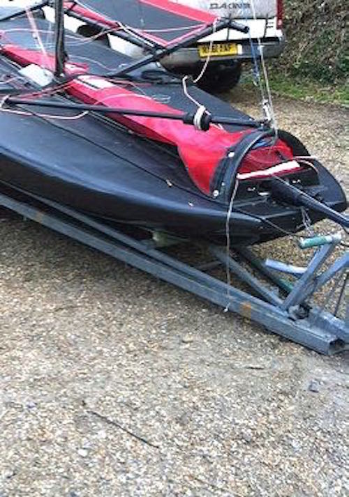

I messed about with this concept for ages and the problem with the solid pipe idea was that it messed with the jib slot and got in the way of it, I used a self tacking jib at the time, the best thing I came up with was a massive opening, which i think is the issue, once the kite is in it'll crush down pretty small it's just getting the whole thing in to start with and it can be prety big and bunched up with the head foot and clew all trying to come together almost simultaneously.
So that thing we made for the V twin worked pretty well, it was one of the actual sucesses of that misdaventure, I'll see if I can't find a picture to attach, nothing you can buy I fear it was made for the purpose. But if it helps prompt something from your head then it'll have been worth it.
