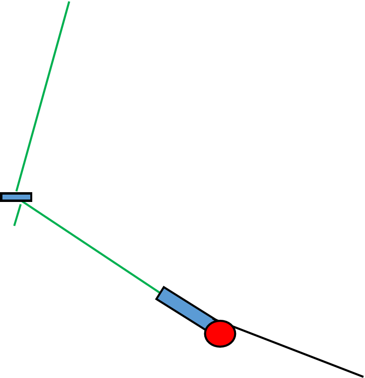

Did you have to colour the ball Bright Red Mozzy??? :-)

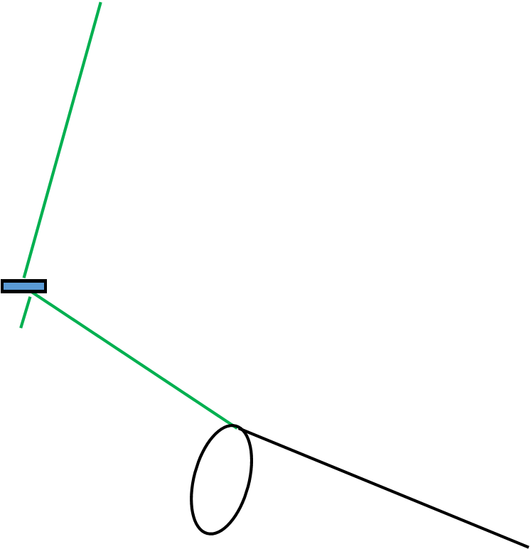

If the elastic went to the top of the keyball handle, rather than toward the bottom it would mean the ball would always dangle down (ooh er) making it possible to hook on without a second hand.
As it is, with the elastic fixing near the bottom and adjuster rope at the top, the system pulls in-line when you go out on a handle. This makes it harder (impossible) to locate the keyball in to the harness without using a second hand. On a traditional hoop the elastic fixes within a cm of the bottom of the adjuster rope so the hoop always hangs down, making hooking on much easier and often you don't need a second hand to do it. ![]() ![]() Edited by mozzy - 19 Jun 18 at 10:29am |
