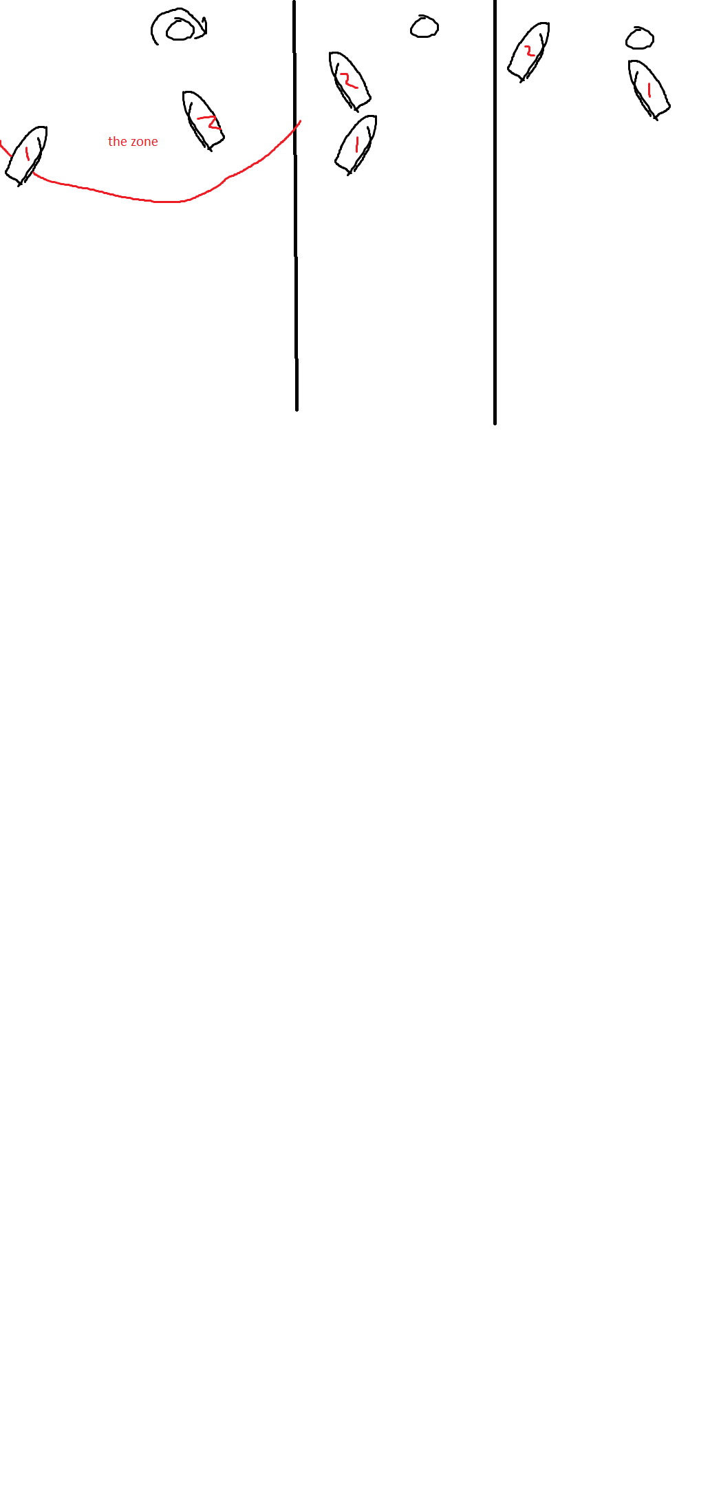

Post Options Post Options   Quote Brass Quote  Post ReplyReply Direct Link To This Post Posted: 26 Apr 18 at 9:17pm
Originally posted by ClubRacer
Like Wiclif said though, you need to anticipate early if you're P.
If 1 Ducked 2 inside the zone then when they both tacked would 1 have right of way over 2?
Yes.
Which boat is the right of way boat is not affected by being inside or outside the zone.
if you enter the zone and mark room rules are off can they ever switch on while you're inside the zone?
Yes.
The most common way that mark-room is switched on is under rule 18.2( b ), which depends on a boat being overlapped or clear ahead when the first boat reaches the zone.
Rule 18.2( a ), however does not depend on what happened at the zone boundary, and if rule 18.2 ( b ) (or rule 18.3 ) does not apply rule 18.2 ( a ) will.
Looking at the third diagram above:
  • Initially no mark-room applies because #1 will have to tack at the mark.
  • As #1 luffs into her tack, rule 18 still does not apply, #1 continues to be right of way boat, but is required by rule 16 to give #2 room to keep clear, which she can readily do by herself luffing.
  • The instant #1 passes head to wind, she will be on the same tack as #2, overlapped inside her:
-   #1, while tacking  is required to keep clear of #2 (rule 13), but
-   #2 is required to give @1 mark-room (rule 18.2( a );  and
-  If #1 breaks rule 13 while she is sailing within the mark-room to which she is entitled, that is room to round the mark as necessary to sail the course, she shall be exonerated (rule 21)
It would normally be dumb for #1 to tack inside #2 at this point.  Her better tactic would be to stand on and put #2 about, then tack for the mark while #2 was tacking away.

Post Options Post Options   Quote ClubRacer Quote  Post ReplyReply Direct Link To This Post Posted: 26 Apr 18 at 7:58pm
https://imgur.com/a/wMDZdRP
Edited by ClubRacer - 26 Apr 18 at 8:00pm
