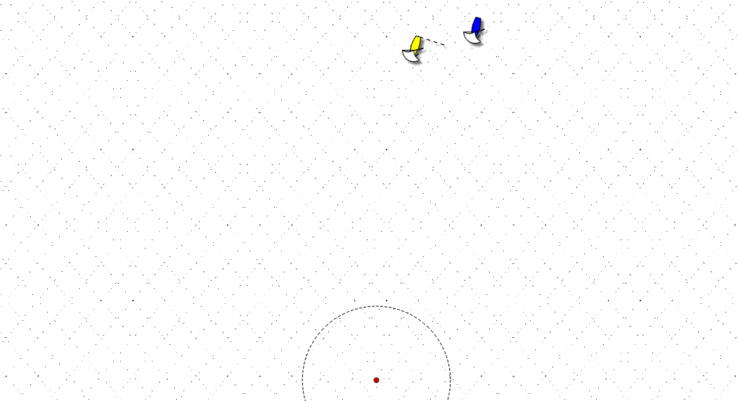

I'm a sailor returning after a brief sojourn of about 20 years. This is my first post, so please be gentle ! I've been crewing in a cruiser racing series for the past couple of months, which I've been enjoying immensely. I'm looking for some advice on an incident in our last race. We were reaching towards the mark, but still well outside the 2 boat zone when we managed to establish an overlap on another boat to windward. We were both on the same port tack and were sailing a direct line to the mark (no luffing up). There was no collision, but we got very close (within about a yard at one stage). We were both insisting our right of way. We had a fairly friendly but passionate discussion about it in the bar afterwards. We believed that we had right of way as we were the boat to leeward and so had the right of way, the other boat stated that the overtaking boat (us) has to stay clear of the boat being overtaken. I couldn't remember ever hearing that one before. Since it's been about 20 years since I last read the sail racing rules, I've just reread them and can still find nothing about the overtaking boat, however managed to find it in the Collision Regs. Reading the Colregs there's a lot of contradiction between them and the Sailing Rules, especially around approaching a mark etc. As I understand it, we race under the Racing Rules of Sailing http://www.sailing.org/documents/racingrules/ and so assume that these take precedent over the colregs, but is this correct ? Can somebody please explain: 1) Who was in the right ? 2) Which code takes precedent ? Thanks. |

silversailor ![]() Newbie ![]() Joined: 07 Jul 17 Online Status: Offline Posts: 3 |
Thanks Sam,
We were well outside the three boat zone when this happened, and by the time we reached it we were several boat lengths ahead. I take it from your reply that you agree we were in the right ?

"Overtaking boat keeps clear" is rule 13 of IRPCS. IRPCAS can't deal with mark rounding (hence RRS). A diagram of your situation would help. |
Thanks all. That's kind of what I thought about the Colregs, but one of their crew was so insistent about the overtaking boat keeping clear that I thought it may have some virtue.
We were about 200 meters from the mark when we established an overlap. At the time they were about 20 meters off our port beam and they weren't restricted in their ability to maneuver to windward in any way. The incident happened as we converged moving towards the mark. We were also both sailing a straight course to the mark.
