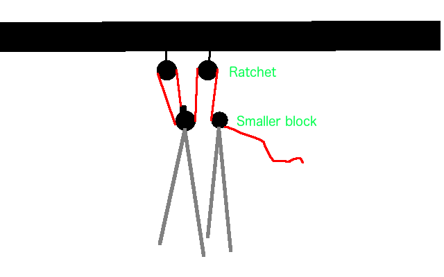

I've seen that the Supernova class and some others have an interesting arrangement with the mainsheet in that they have two bridles, one for the block with a becket and then another one for the last block which is usually a smaller block with the ratchet block being on the boom. What is the advantage to doing this?

Plenty of possible ideas going on but I'm having a punt on one here, ratchet on boom would give 180 degrees of wrap so best possible holding power.

That's certainly true. Could do that with the sheet still coming off the floor though but then again you're using lighter blocks in general with the small block being the last in the series. Saves a fitting on the floor as well.

Have you got any closer pics of that arrangement or could post up a schematic? My arrangement has just ripped the top of the turret off my Solution set up so I need to get something sorted for the weekend, I doubt a new turret will arrive in time and that looks interesting.

My guess is better alignment of the blocks, so less friction.

Post Options Post Options   Quote Glitcher7 Quote  Post ReplyReply Direct Link To This Post Posted: 04 Jan 17 at 3:59pm
Farr 3.7 398 in build
Laser 137012
Norfolk Punt 100

Post Options Post Options   Quote Guests Quote  Post ReplyReply Direct Link To This Post Posted: 04 Jan 17 at 4:27pm
The block on the boom is the last block 'adding purchase', with the floating block just a turning / routing block.
To get most benefit from the ratchet you want it at your end of the purchase system, but you also want a decent 'wrap' on the block. Moving it to the deck doesn't get it any closer to you in the purchase system, but just mean less wrap, so I guess that's why.

Post Options Post Options   Quote Alistair426 Quote  Post ReplyReply Direct Link To This Post Posted: 04 Jan 17 at 7:17pm
Two oft quoted advantages from Supernova-ists are that i) it removes a source of tangles (ratchet on floor) and ii) with the end of the mainsheet coming from higher up, it provides greater support whilst hiking. I think they are mostly secret Mothies, if you ask me  Wink.

Post Options Post Options   Quote Sam.Spoons Quote  Post ReplyReply Direct Link To This Post Posted: 05 Jan 17 at 12:35am
Sheeting off the boom, skiff style, removes yet another potential tangle and gives even more support for hiking.... I've converted my Blaze to rear bridle/OTB after a single race (for completely different reasons BTW but that twin bridal method would not work as well on the Blaze). The Spice will remain 'conventional' centre mainsheet as it seems to work best for that boat.
