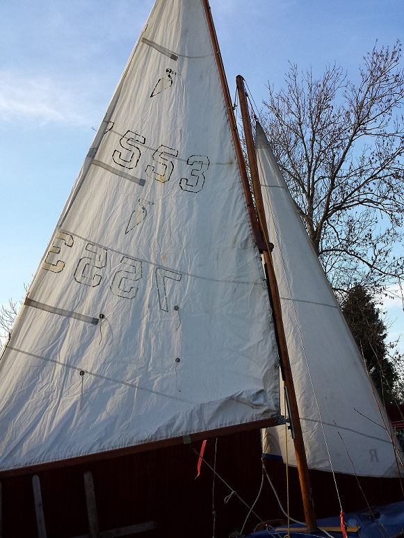

Thanks for this SoggyBadger. I've managed to get the gaff hoisted right up against the mast which in turn means the boom goes up nice and horizontal. I've got the sails up and all looks good. I just need to work out how the mainsheet goes from the boom through the block on the transom back to the helm. I'll look into Dyneema as I guess that this type of setup could lead to some stretch in the halyards. I do wonder if they do sag a tad as the gaff looks like it drops a touch after I tie it off, so if that is the case then the Dyneema could sort that - cheers for the suggestion. After that, I need to work out what all the different sails that came with the boat are for - it came with a number of them! And also then start tidying it up! I'll see if anyone can offer any suggestions for that in a new topic. Regards, Greg |

Greg you need to get the gaff hoisted as close to the mast sheave as possible. Do that before you put the boom on the gooseneck. I'd also advise replacing the halyards with Dyneema to minimise the stretch.

Worth finding some battens to go in the sail, Greg - makes a world of difference to how the sail looks and works.
You are quite right that getting the gaff right to the mast will help with the boom. Another place to go for advice on all things paint is the cvrda - www.cvrda.org. |

I did have a look at a brief guide with diagram for rigging a Mirror, but found that a bit confusing so used the head scratching & tinkering approach (I did read on here about a mention of a Heron manual that someone produced, but haven't managed to find it). I will look out for Sailing the Mirror by Roy Partridge though - thanks for the suggestion Rupert. However, after a few attempts I think I'm getting there with rigging it. Attached is a picture of my progress so far... ![]() The boom is not horizontal but I think I just need to hoist up the gaff a bit more as still at a bit of an angle. JimC, you mentioning the need to tension the halyard as tight as you can makes sense with this, as I think I do need to pull that up more to get the gaff right up against the mast and that will in turn bring the boom up to horizontal. As long as that is all it needs, then it is looking quite simple after all but it took getting all the bits out and having a play with it to work it out! ColPrice2002 - thanks for the link. I emailed the association to check if it still has an active following, and they have replied back to confirm there is a very active following, which is good news so I'll join up shortly and perhaps see if they can offer some advice on removing the flaking paint and repainting it! Thanks again. Greg. |

Gunter rigs are fairly simple really. There are variations, but most likely there's a track on the back of the mast and a slider on the end of the gaff. Then a foot or so further up the gaff from tge slider is some kind of attachment point.
You thread the mainsail onto the gaff and tie it off to the top. Then you tie the main halyard from the top of the mast onto tge attach point on the gaff, then engage the slider on the mast and pull the gaff up. Normally you tension the halyard as tight as you can so the gaff is rigid against the mast. |
