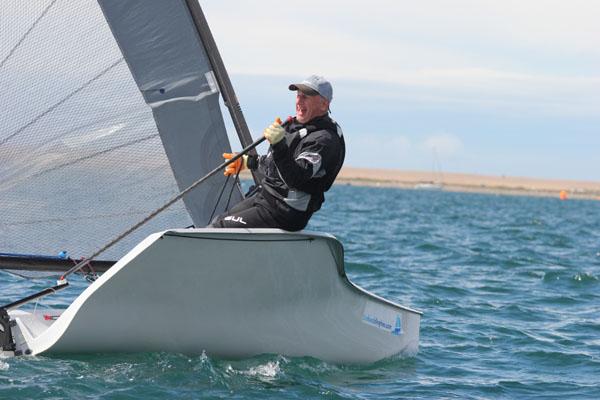

Hi Dan, can you clarify 'hollow' for me please? Does an RS300 have hollow topsides?

I suppose he means that the sides are would be concave for hollow and convex for the other. The RS300 sides are straight so not sure that its either

Post Options Post Options   Quote Steve411 Quote  Post ReplyReply Direct Link To This Post Posted: 29 Mar 13 at 10:43am
RS Games - RS300 nationals - photo © Mike Rice / www.fotoboat.com
As you can see, there is some hollow in the 300. (Pic by Mike Rice of Fotoboat from Y&Y photo gallery).
