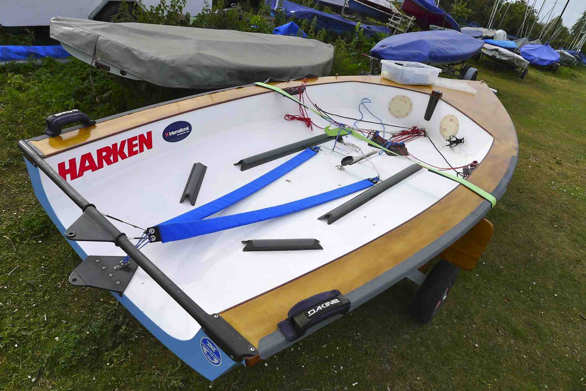

I was going to mention the state of your Progrip, but having just caught up with your blog see that you've just sorted it. Well done for sourcing that 'Progrip' at such a nominal price! Nifty idea for applying traction to the minor repair as well Daryl.

Post Options Post Options   Quote bferry Quote  Post ReplyReply Direct Link To This Post Posted: 09 Nov 11 at 10:33am
Yes, love the BLUE footstraps...very classy LOL

Post Options Post Options   Quote G.R.F. Quote  Post ReplyReply Direct Link To This Post Posted: 09 Nov 11 at 9:26am
Nice footstraps, brings a touch of class, interesting boat, why did I previously think it had a centreboard?
