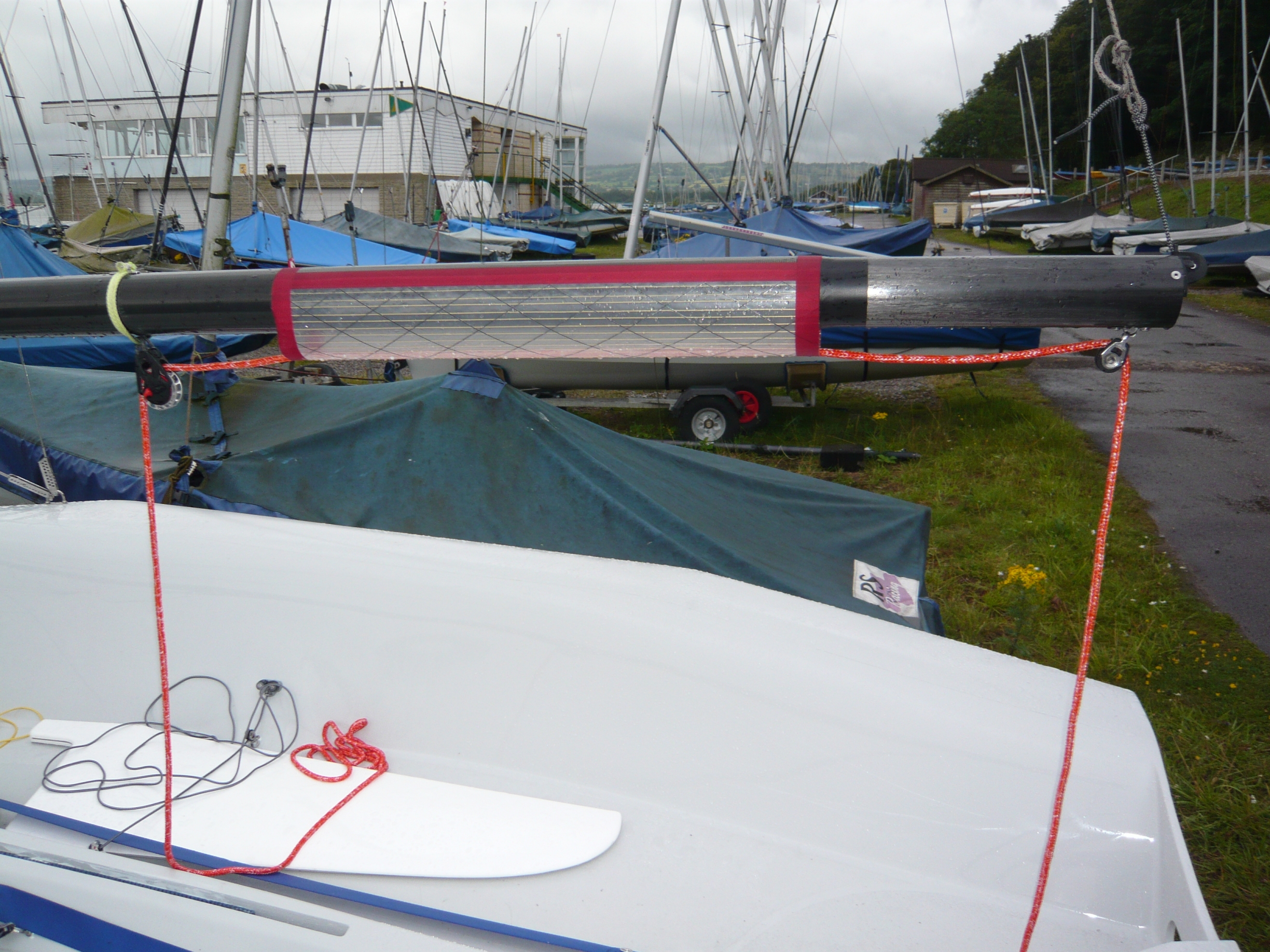

I'll take photos on Sunday, but here a description:)
orange mainsheet
blue with yellow specks jib sheet
blue toe straps with yellow bungee and rope
navy/White kicker with yellow cascade bits
red/White jib halyard
name? That'll be revealed when I hit the water.

^^^ The orange mainsheet - doesn't look so bad. The bridle, not attached in the photo, is yellow just to set it all off. All in all it looks fab imo!

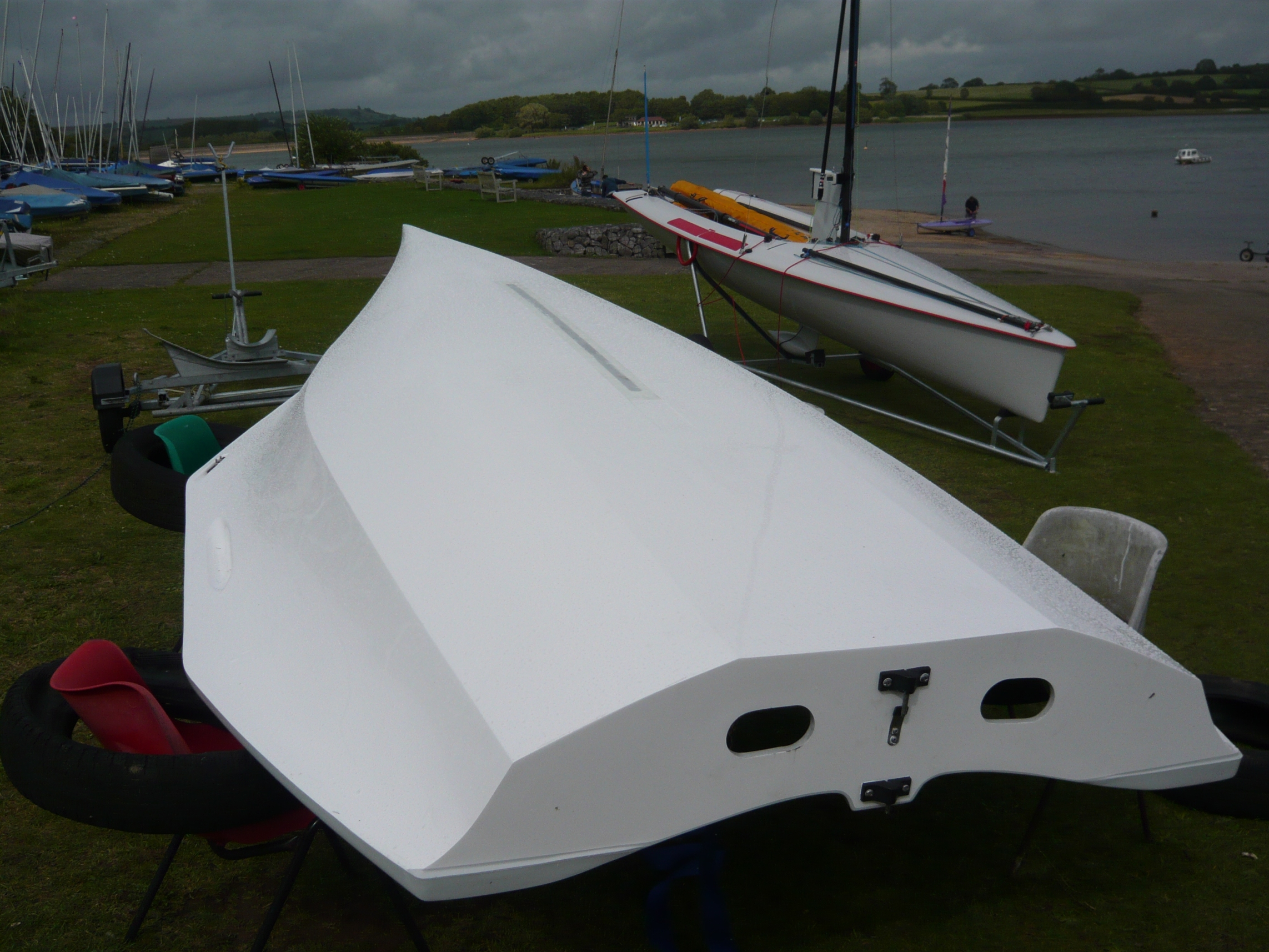

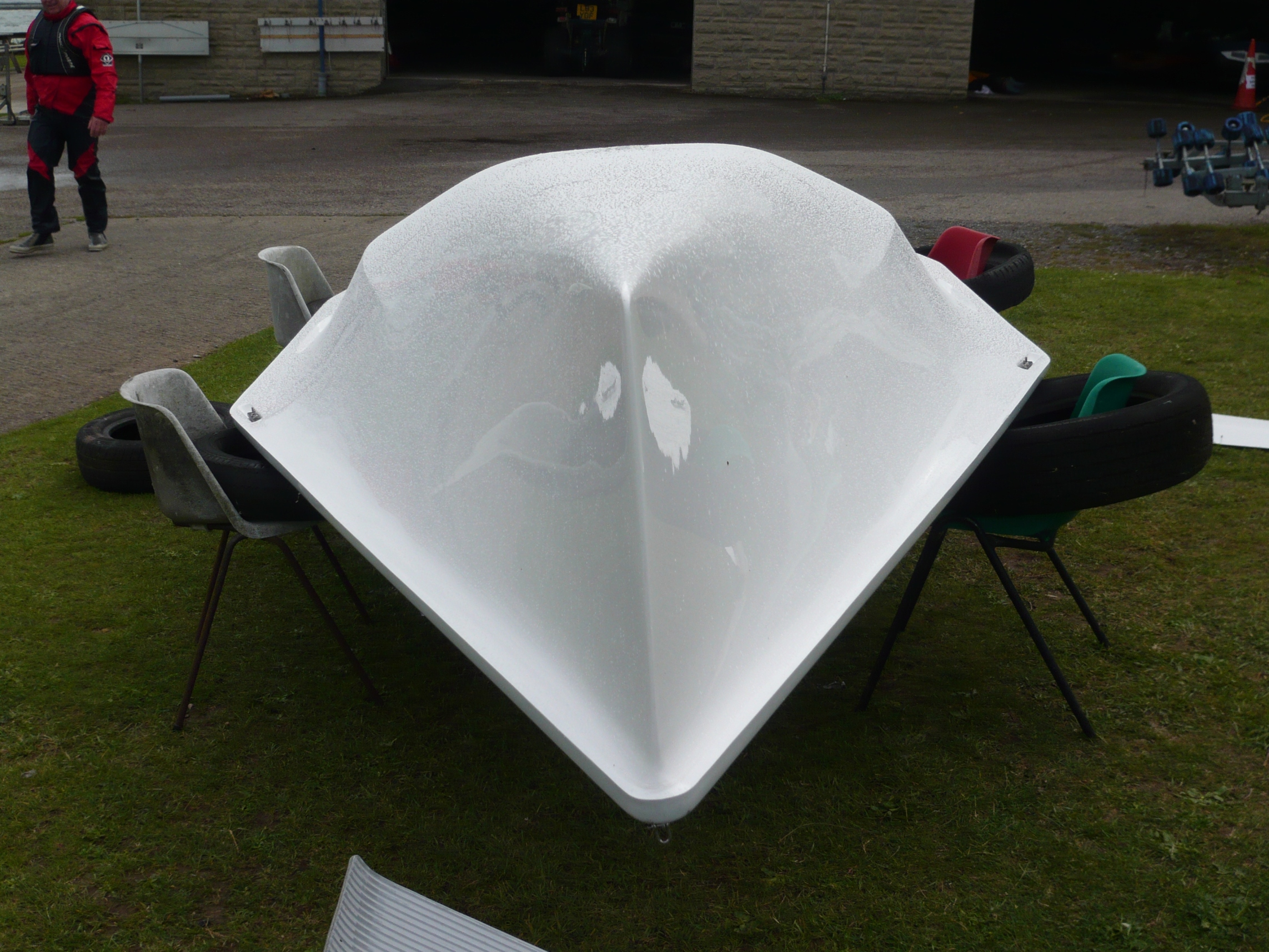

Good piccy's, interesting how narrow the bows look in the front-on view compared to the stern-forwards view, great shape.  As for your rope colours' being 'co-ordinated' .....

The bows are 'elongated' but the camera angle does exagerate the fineness of the bow a bit !  The boat is amazingly stable for all its in-built hull design efficiency and is still rather foregiving but it 'works' as anticipated in the light stuff and is equally fast when it blows.
Now Peaky ... lets see what goes on the water !  ... and we are still waiting for the name.

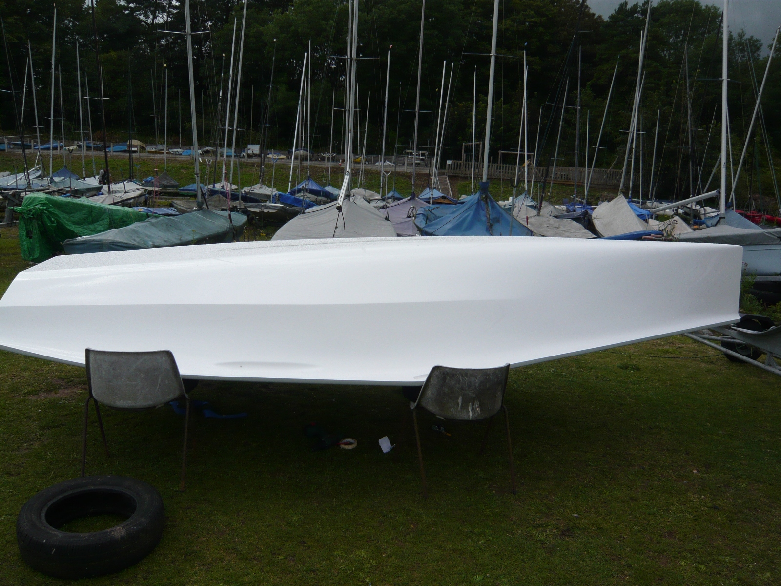

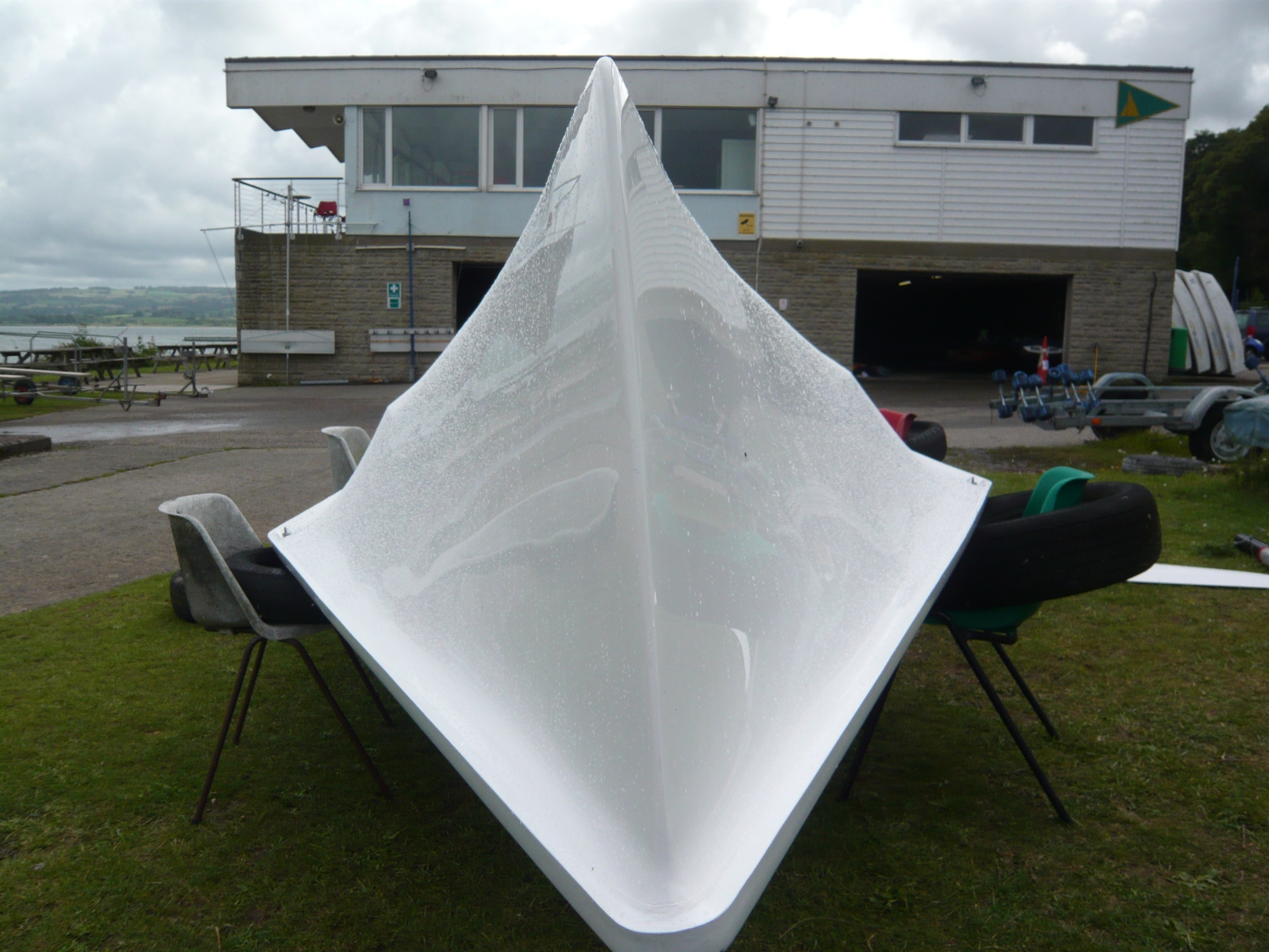

I really like the Orbit block too, but have gone for Harken ratchets for the jib because I was very impressed by them on Mike's boat.
Mike - you need to come across to Chew for Visitor's Day and the RNLI Trophy in mid October. That's if there's any water left in the lake by then!
A couple more upside down shots:
