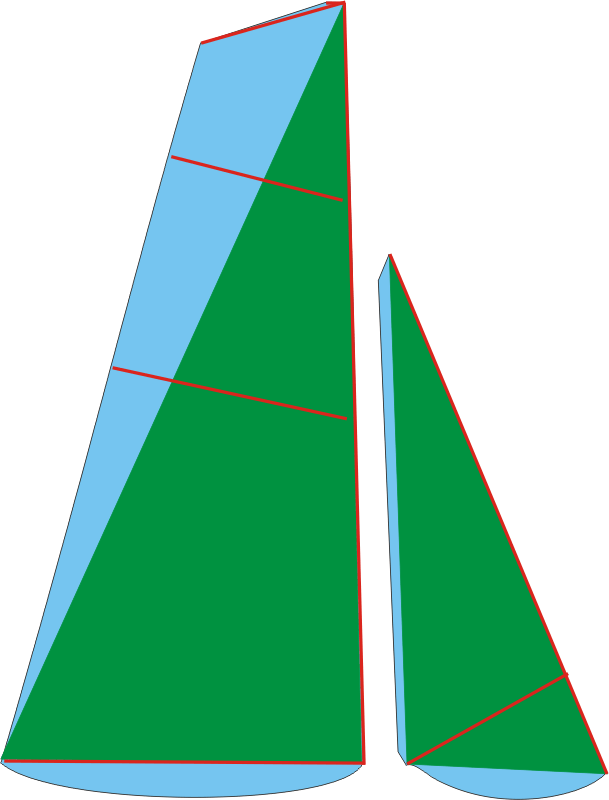

Post Options Post Options   Quote JimC Quote  Post ReplyReply Direct Link To This Post Posted: 15 Mar 14 at 8:21am
This is what I get *IF* I understand the rule correctly:
- the measured sail area is in green
- the red lines are the measurements which control the sail shape
- the blue is an approximation of the actual sail shape, controlled by the measurements and the rules on corner reinforcement. The actual permissable length of the red lines is controlled by a formula which relates one to another and basically means you get to choose between a smaller, thinner taller sail and a shorter, fatter and slightly larger one. Its a very 1920s way of measuring sails, but if they moved to a modern method of measurement that measured real area without the complicated formulae and strange restrictions then they'd all get to throw all their sails away and their rigs would look quite different.
There's nothing really wrong about it: the sails are compared equably and consistently and the measurements are reasonably quick and easy to do. You just have to be aware that the sail area total is a fiction that has little to do with the real area.
[and, added later] I hadn't even noticed sugmeister had left off all the important stuff. I worked the drawing out last night from reading the rules on the RYA website. As Craiggo says, measuring crosss widths is common enough in one designs, the MR system just puts a formula on top of it which spits out an area.

Ah! But Sugmeister has fallen right into the trap. From an area measurement then yes only the triangle is considered, but the next paragraph in the rules which he kindly failed to copy and paste, lays down the maximum chord length at several stations, including max. Batten lengths. It is these extra rules that then limit the leech profile and the roach. This style of measuring was very common across most class's, and is still used by a lot of the 50s and 60s class's.
