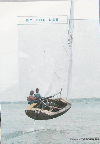

Originally posted by tick
I believe that DCB has quite a lot of rocker which sweeps the stern wave up and off the transom. Does that mean that a boat of lesser performance but similar characteristics would also benefit? How about a "T" foil Wayfarer?
Like this one?
Direct Link To This Post Posted: 24 Jan 13 at 12:08pm
I think I'll enter the BM in a T foil Firefly next year. No one will mind...
