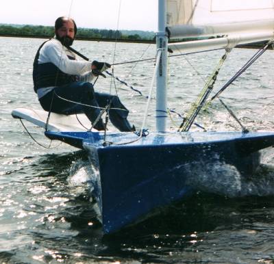

IMHO that's one thing I got right with my PlusPlus. Can't find a really good photo, but basically there was a floor stepped stump which was supported by lowers and a prod with the gooseneck on. The mast itself socketed into this with something like a 12mm stainless steel pin holding it in place. Take out the pin and the mast telescoped down to the bottom of the stump. There were alternate eyes on the shrouds and forestay, like an RS600. To stump the rig down you pulled out the pin, attached the shrounds and forestay to the higher position with fast pins, and pulled the rig tension on again. To take the rig up the opposite. Then the sail had a slab reef with a zip to roll it up neatly. To stump the mast down took under a minute and could be done on the beach or even tied up to a pontoon without even taking the sail down. The sail took a little bit longer to get it neat. The trouble was, as I said, if there was any chance at all of hanging onto the big rag upwind you had to do it because of the gain on the runs. ![]() Edited by JimC - 07 Oct 13 at 2:03pm |
