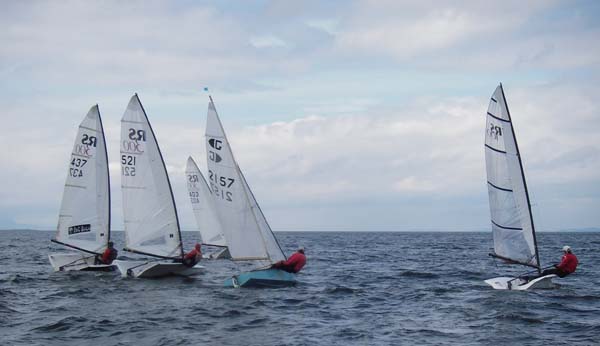

Re upwind sheeting, pic of first race start yesterday, about 11mph. No idea whether thats too tight or whatever, so any experts please say.

I'm not an expert !!!!!! Very interesting photo - a great start by the way and very nice trim ! You look to be sheeted a bit tighter than I have doing - traveller appears to be 100 to 150mm off the stop (would be good to see a higher res close up shot) and possibly as a result bottom battens maybe look a little bit hooked compared to the 300's, although could be an optical illusion. Any other shots ? Edited by ChrisC |

It might just be the angle of the shot but the mast looks to be bending in a funny way! Strait at the top and bent at the bottom. EDIT: Could be a Gnav thing? Edited by Ross |

As Ross says, it might be the angle but...it looks almost 'S-shaped'. Are the spreaders a set length from RS or can you fiddle with them? Looks as though the mast is being dragged too far to windward at the spreaders.
