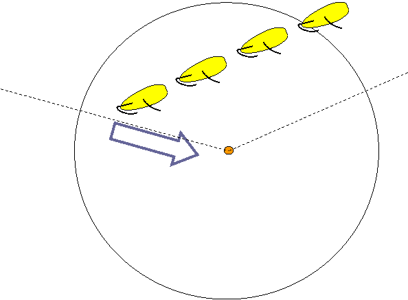

Gordon,
Notwithstanding the words in Case 75, I would suggest that for a stbd tack, mark-room entitled boat whose proper course is to sail hot, as shown in the attached diagram, her 'corridor' _to_ the mark is the Arrow on the course from the point where, under rule 18.4 she is obliged to gybe (or wherever she actually gybes before that).
Surely the rules can't mean that a boat in this situation may sail to her rule 18.4 port tack layline, then, on gybing, instantly be three boatlengths away from her 'course to the mark'?
Your thoughts?

gordon View Drop Down
Joined: 07 Sep 04
Posts: 1037
Post Options Post Options   Quote gordon Quote  Post ReplyReply Direct Link To This Post Posted: 01 Jul 10 at 8:29am
Brass:
The rules give to the boat approaching on starboard, and inside or clear ahead at the zone:
- an entitlement to mark room, that is an entitlement to sail directly to the mark along a narrow corridor. This entitlement would be available even if the boat was not a right of way boat. This entitlement remains until the boat has passed the mark;
- right of way over any boats on port, overlapped to windward or clear astern. This ROW can be lost during the mark rounding.
In this case, Yellow may have right of way by virtue of being on starboard, overlapped to leeward or clear ahead.  Port tack boats will have to keep clear whilst she is on starboard. If she has a boat overlapped on the outside to windward (boats on port will be overlapped) she is obliged, by rule 18.4, to sail no further than her proper course (the port lay line) before gybing. Naturally rules 15, 16 and 17 may apply, and restrict her course
If, after gybing, Yellow ceases to be ROW, there may be a boat overlapped to leeward, then she is obliged from that position to sail directly to the mark. The corridor is only defined when Yellow loses ROW.
 However, I would suggest that Yellow reads Case 25 attentively. When room is made available at a mark to a boat not entitled to it, she may, at her own risk' take advatage of the room. Yellow is vulnerable to a boat arriving fast on port, passing astern of her as Yellow gybes and rounding the mark with speed!
Gordon
Gordon

Brass View Drop Down
Joined: 24 Mar 08
Location: Australia
Posts: 1151
Post Options Post Options   Quote Brass Quote  Post ReplyReply Direct Link To This Post Posted: 01 Jul 10 at 1:07pm
Gordon
Case 63?
Won't a late arriving port tacker have been Outside boat when Y first reached the zone and thus owe Y mark-room?
Why do you say that a boat loses an entitlement to mark-room to sail to the mark when she has passed the mark (provided she is still in tha zone)?
Edited by Brass
