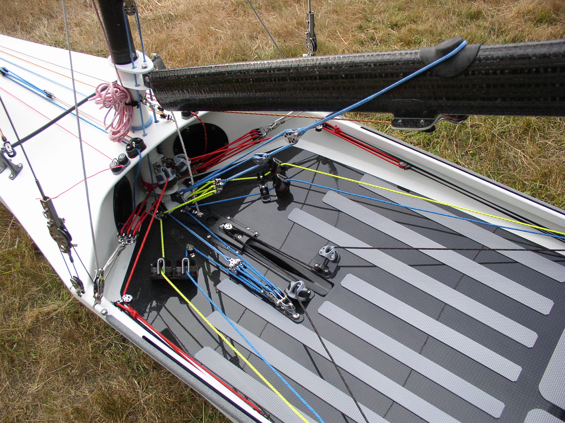

You could 'spring' the diamond, so more pressure gives max angle and less pressure reduces it, but I'm not sure that's the way round you want it, then actually you could spring the other side for the opposite effect, wait a minute, this needs more dwelling on, so like a suspension ATB you springload with adjustable tension, I'm going to think further about this...
Woa, so what is this? I guess it's one of those International 14 things you see coming up on ebay for a fiver from time to time looks very narrow for something that has so much power (and string). So does the diamond form part of the case or is it a carrier for the daggerboard inserted into the case? They leave the daggerboard down as long as possible if I recall, Assym style I did work out why that worked, a collosal waste of power but I can see why it's effective, so they leave a plate down fully gybed even going downhill? Doesn't that seem a little draggy?

I think its and Int Canoe.
Boom to low for a Int14 and no carbon tubes for wings out the side, but I cant see the sliding seat either so not 100% sure.

Its definately an International Canoe
