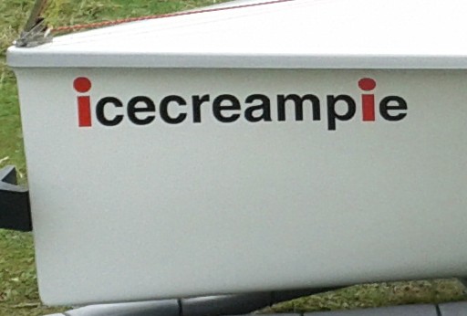

At long last we are not just a number...........
Icon 04
Blaze 840 "Ate For Tea" |
Eye eye not another arctic roll?
