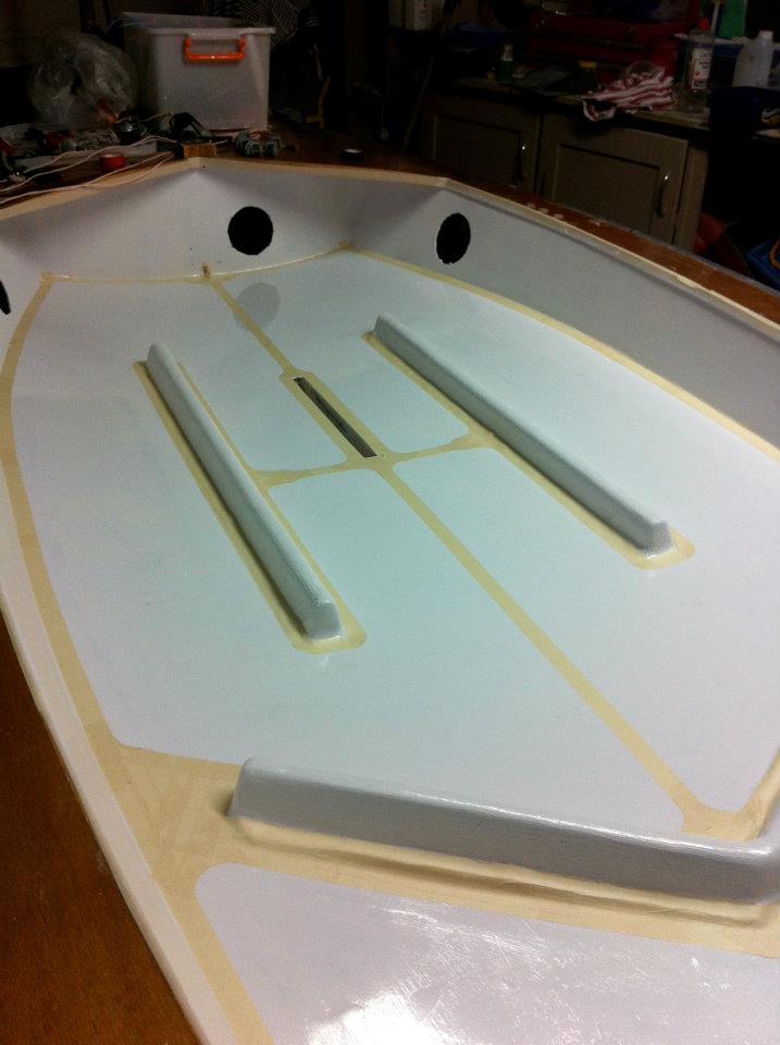

I think you'll be adding needless weight if you do re-peel ply, as you are going to need to coat the floor in paint to stop UV rays damaging the epoxy. And this will fill in all the holes left by the peel ply. Much better to ether go straight on top with ProGrip.
OR
Fill and fair around the floor edges and case (for prettyness and lack of grazed knuckles), when dry mask and paint the edges with 2 pack. When dry mask off the painted areas and then paint the area to be gripped with 2 pack paint and sprinkle sugar over the top. When the paint is dry wash off the sugar and you are left with a textured surface.

like this:

All I can say about that stuff i used... CR@P .... It doesnt give you any grip when the floor is soaked, and all it is good for is ripping gear to shreds..  Cry
If it were me, I would be going with one coat of paint to seal it, figure out where you want progrip, and paint around the marked areas to give the shine where the grip wont be, Then ProGrip the floor where you marked out previously.

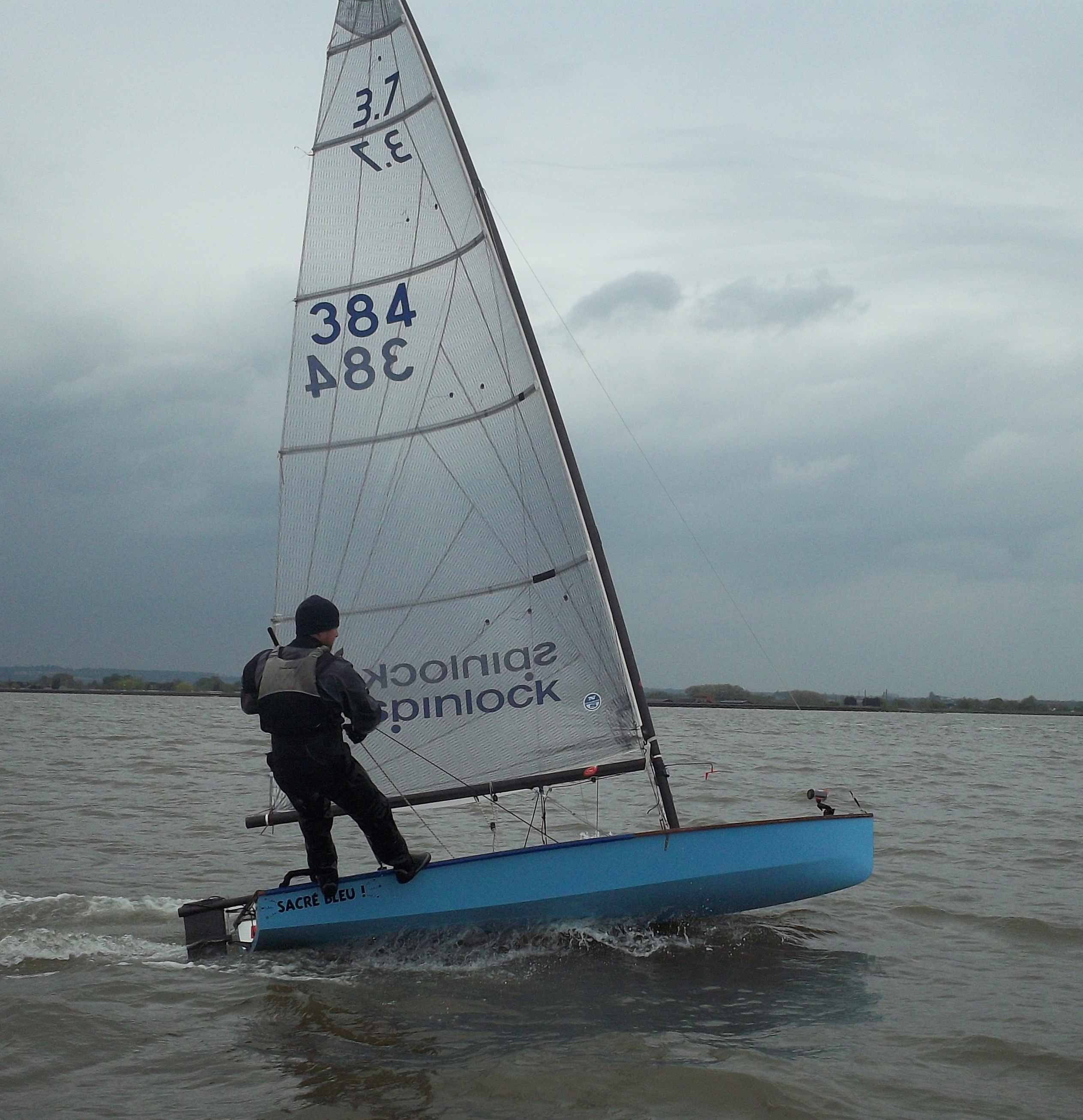

Nice little video from a young (17?) English born New Zealand Farr 3.7 sailor showing that the 3.7 is a very manageable boat even in what looks like quite variable conditions.

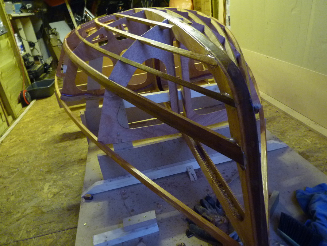

Yes, Dave is getting to the painting stage. There is a 3rd. There was a 4th but it got destroyed by a flood.
