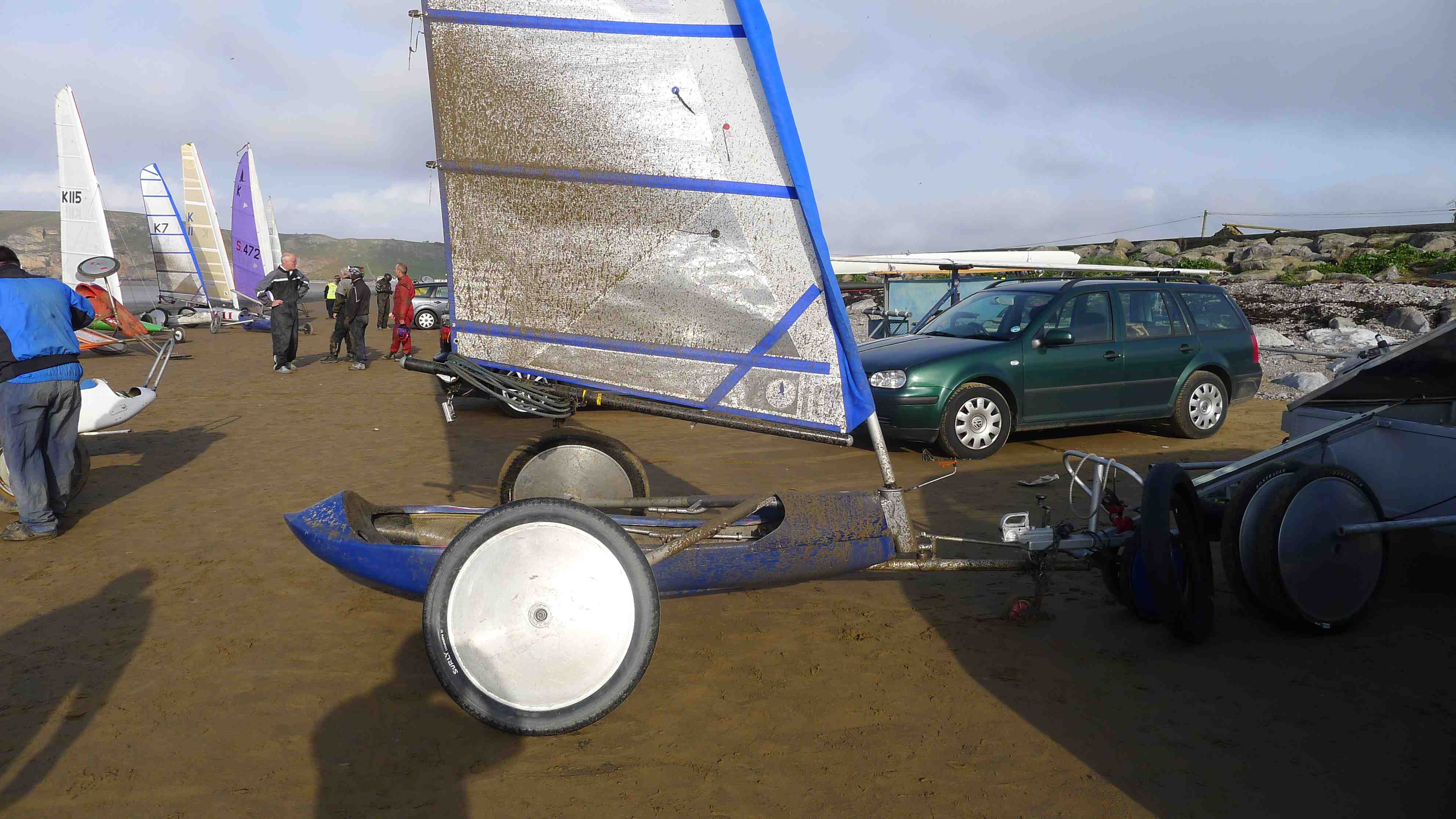

"Yorker" Class 5 Landyacht forsale - £495
26" ally wheels (NZ) with Hookworm's & Slicks Harken blocks R&J sail PM me for more info. ![]() Edited by Jack Sparrow - 08 Nov 12 at 11:56am |
