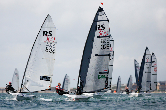

Originally posted by SimonW99
Finn mast is massively stiff remember. I believe the aero is very flexible. Oh and the RS 300 is dacron... for about 10 inches back from the luff- its there to give stretch.
Yes, it's clearer on the black sail below. It's dacron near the luff to help cope with the huge mast bend when the kicker's cranked on - the rest of the sail is laminate.
Steve B
RS300 411
RS300 page

Steve and Simon, thanks for the input, looks like the 100 is the same set up but it doesn't get RS out of jail, if they have a solution for it why not implement it?

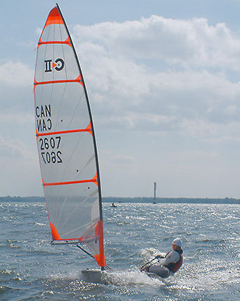

Is this a better example?  Byte C2 can't see any dacron here.
Post Options Post Options   Quote Guests Quote  Post ReplyReply Direct Link To This Post Posted: 03 Mar 14 at 3:52pm
C2 is fully battened.
The 100 is carbon, but has stays which limit the flex.
I am sure that you could do something other than Dacron, but it worked well on the one I sailed, as Rupert said, has a long life and is a pretty easy step out of a Laser, which must be a consideration.
