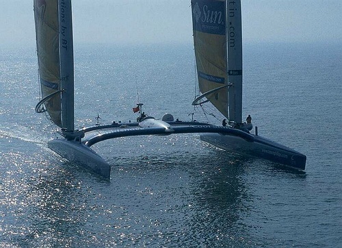

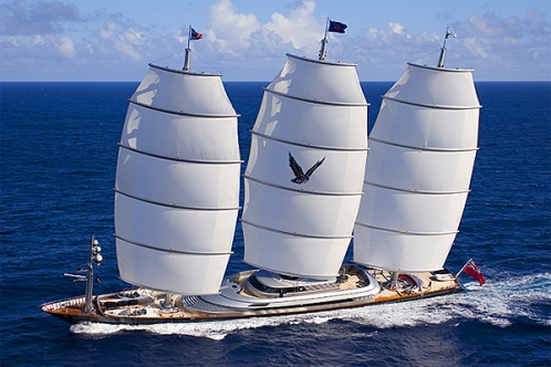

Of course, when it comes to unstayed masts on big boats- there's two high profile examples I can think of.
Exhibit A had big problems with the mast heel bearings on its twin wingmasts.
Exhbit B isn't really a racing boat (though it is cheerfully capable of 20knots under sail)
