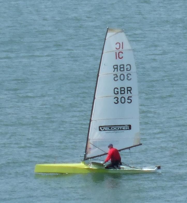

The canoe on the Sailboat stand has a rudder (approx 300mm deep) that drops through the boat as you launch. This is the 'normal' canoe rudder system. You can either put the rudder in in knee deep water or push off and put it down when you get out there. There are other systems that work - dagger rudder hung off the back of the boat - traditional swing down rudder again hung off the back of the boat. One of the great things about the boat - you can fit it out as you want.

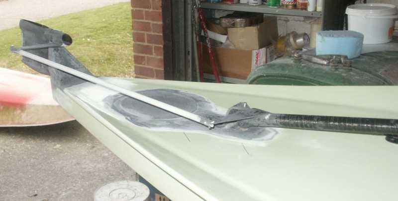

Here's my latest ( 46kg ) Int Canoe with an odd rudder linkage - rudder hung over the back, with the tiller further fwds. ( and two wiggly sticks ) ![]() Development class rules allow all sorts of silly ideas ! ![]() |
