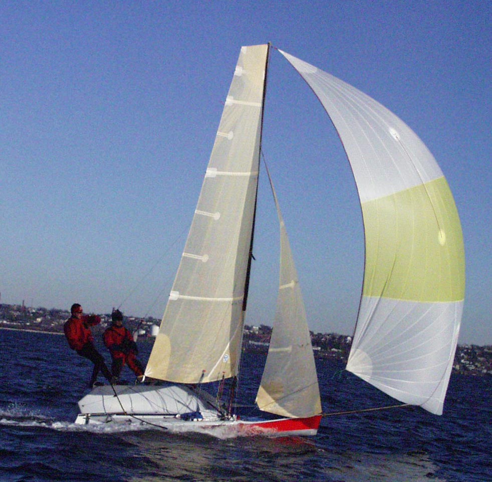

Vector TT;
LOA 4650
Bmax 1280
all up weight 90 kg
Upwind area 16.82m^2
Kite 25.75m^2
So in between the 800 and XX.
SHC
Post Options Post Options   Quote Guests Quote  Post ReplyReply Direct Link To This Post Posted: 05 Jan 07 at 5:19pm
Is that Bmax supposed to mean maximum beam or am i just bein stupid and it means something totally different? Because If you are sure that number is right, that would mean you've got slightly more sail area than the 800 but Less leverage than the 29er.......that being the case then im not so sure your gonna be having 2 lightweight ladies holding it down that well.

2 lightweight ladies could never hold that down, also they wouldn't be able to get far enough back to stop the bow going down with the kite up in a breeze.

Post Options Post Options   Quote Steve Clark Quote  Post ReplyReply Direct Link To This Post Posted: 05 Jan 07 at 6:13pm
Dyslexia strikes once every 27 seconds!
the real Bmax ( maximum beam) is 1820mm
BWL (waterline beam) is in the order of 710mm
Rig is pretty soft and the sails generally flat given the belief that big flat sails go faster than small full sails.  Boat has been sailed happily in force 5 with 125 kg aboard with very little drama.
