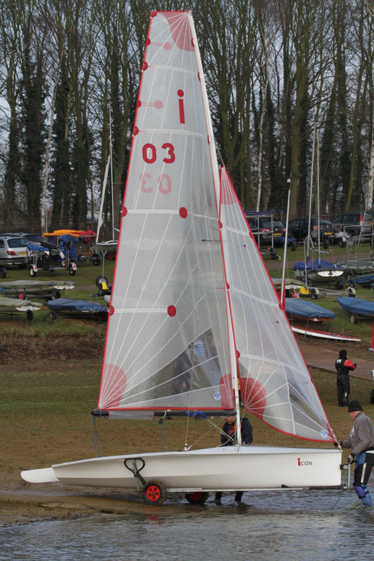

So it looks like a lot of support then !  ... as stated we will be trying one out once the sail plan is totally set.  The ICON foredeck is long and proportionately very much longer than most of the boats being mentioned so the jib will be long in the foot and the pole very long as well.
Any thought out there about other systems to consider ?  What about a light/small carbon 'jib boom' - one that is restricted so it can keep the jib 'down' ?  Any practical input would be useful - if truly practical such a system could give most of 'dangly' benefits without all that 'orrible windage round our v.efficient Icon mast !?

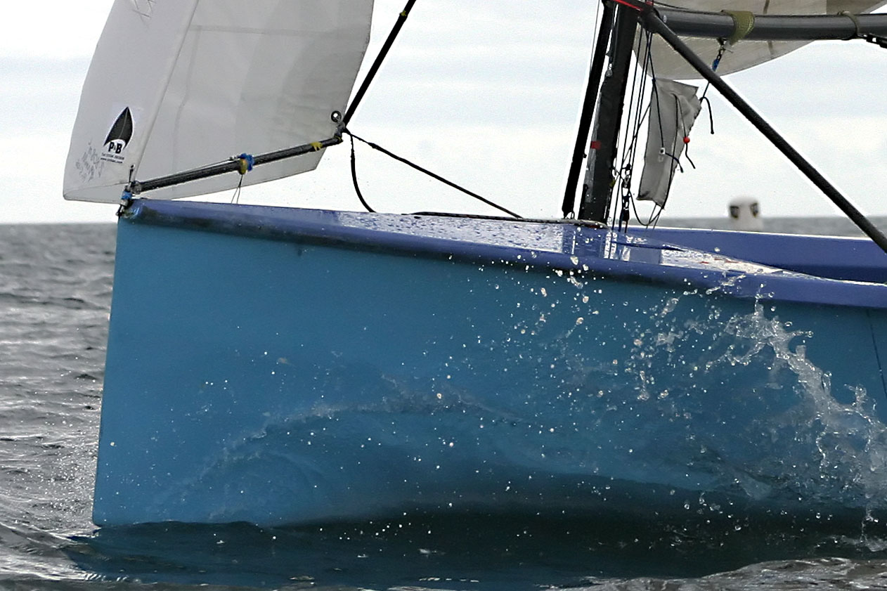

Jib boom being used with a Jibstick.....

Re. the N12 above - a jib boom and dangly stick - that's just crazy!  See how much the main boom is bending though...
A jib boom on its own would help with leach control, but doesn't do much to aid goosewinging, does it?  The K1 has a jib boom which might be worth a look.
