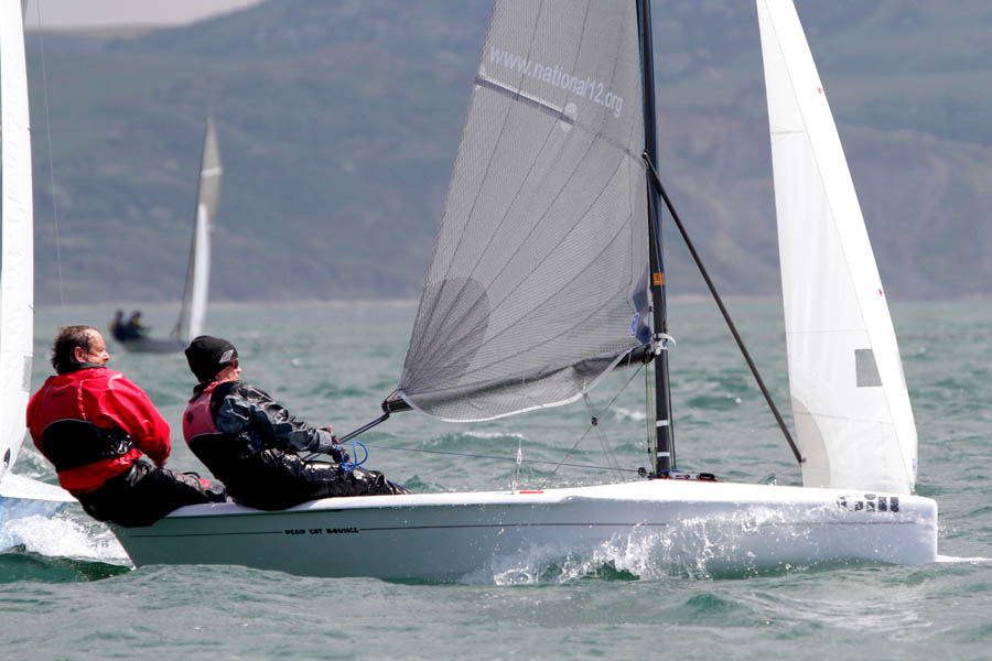

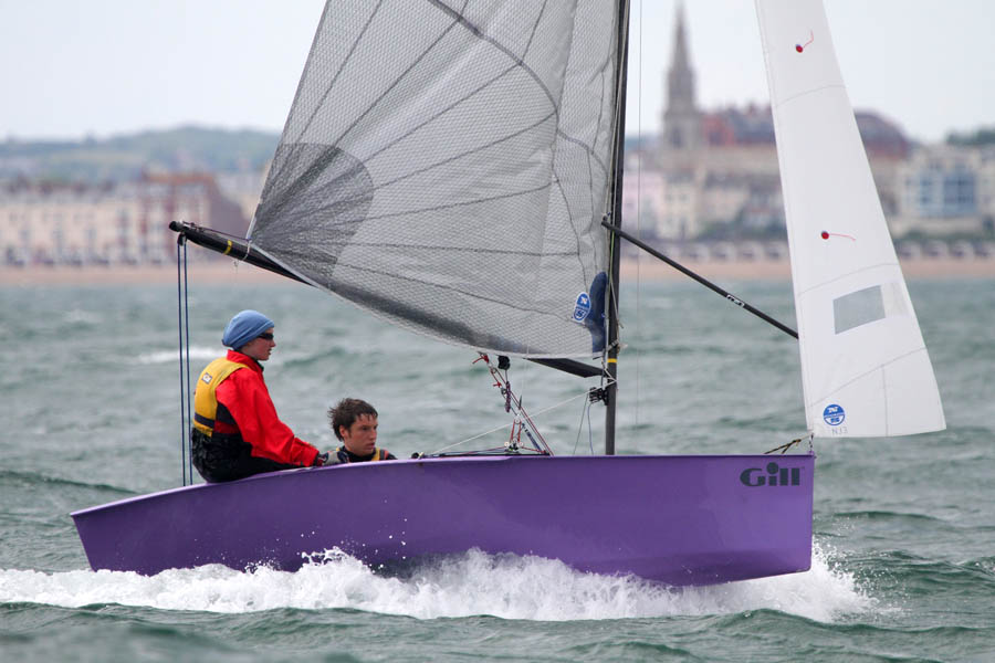

How do you set the pole for reaching (as opposed to running)? Do you only half lower the mast end of the pole - otherwise isn't the front end sticking too far out? If you do only half lower it, is that not a constant adjustement in parallel with sheet tension? Or am I over complicating things?Also, is a pole better, worse or the same as barberhaulers for reaching?
yes, yes, much better. Edited by JimC - 08 Nov 10 at 10:18am |
![]() ![]() The top pic shows the jibstick in goosewinged running position, and the bottom picture shows it in a reaching position, hope that helps. ![]() |
Thanks. On a reach is it just a case of: if the mast end of the pole is too low you can't sheet in tightly enough and if it is too high the jib leach twists too much? Do you have to raise the mast end when you gybe to prevent it whacking the foredeck? Apologies for all the questions.
Yes that's basically it if I remember from back in my N12 days! Gybing depends really, you can leave it on a bit and it will miss the top of the foredeck, we used to have a marker on the control line to show us at what point it won't clang on the deck.
The pole is on elastic so you just retract it when you go into a gybe. The clew position is a balance between the pole pushing down and out and the sheet pulling in, so if the pole is too far out you would need to retract it a bit to let you pull the sheet in. The best crews work both controls in unison, however you can still reap many of the benefits on a set and forget basis. Usually a cleat with a sturdy fairlead to allow cleating/uncleating from interesting angles or a flipflop.
