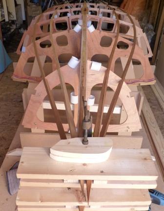

The Farr build is coming on nicely, the rain over Easter gave me an excuse to spend more time in the shed, (dodging a leaking roof !). This shows the first stringers beign steamed into place (I hope)
More on the Blog

Looking good, like the idea of using split drainpipes for clamps... you can never seem to have enough of the things!

Looking neat - but I hope that's a camera distortion I'm seeing in the inner stringer on the port side...

Jim looks to me that he hasnt clamped it at the stem yet as that whacking great G-glamp is in the way, hence the horrible curve.
