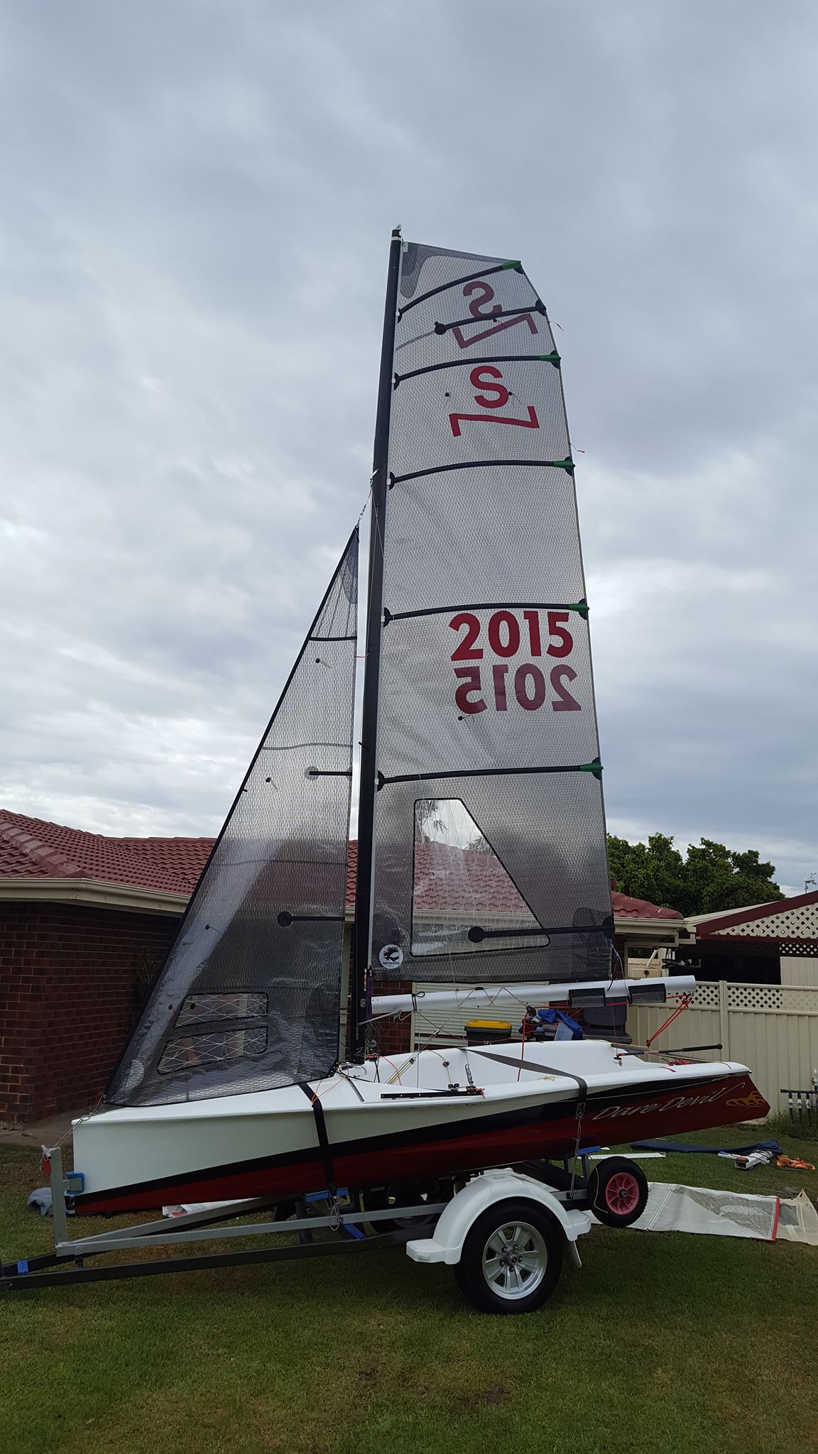

Here's my NS14, which is quite square-topped.  Some are even squarer now.  Like the Tasar, this has a rotating mast.  Mine is quite flexi carbon, tapered above the hounds.  On the water rig adjustment is very limited, so you rely on the main and mast's built-in gust response to a large extent.  It's pretty user-friendly.
