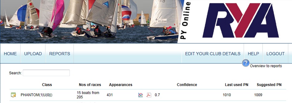

+1 for putting the numbers in PYS website.
I do it for Leigh and Lowton (Inland) and our PY for the year will be 1009 ![]() |
