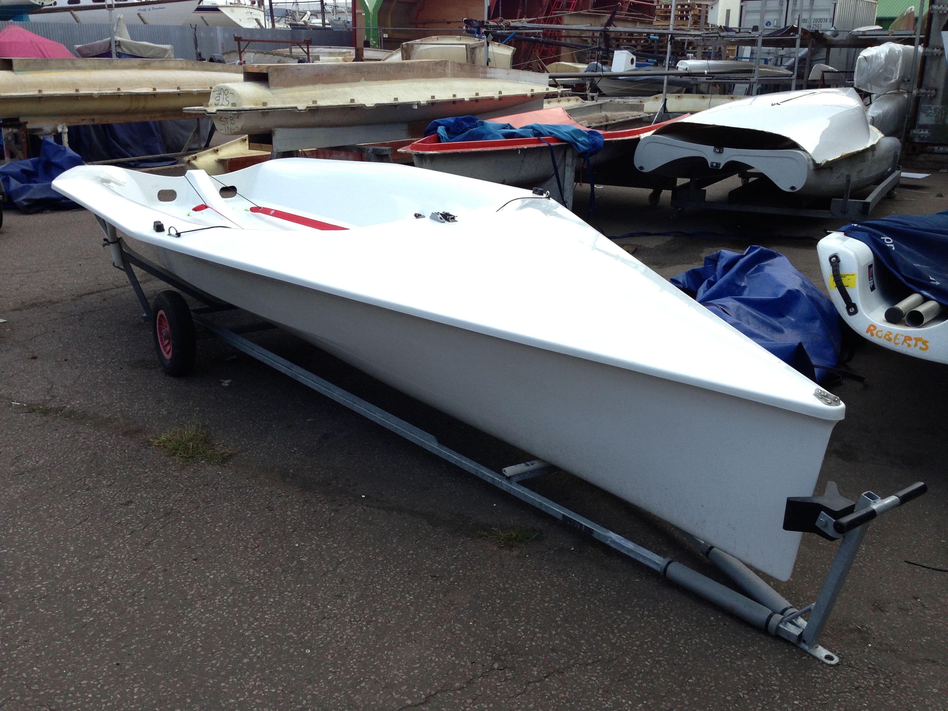

There's a heap of problems with a swing rig, not least the fact that the jib and kite might have more moment on the boom than the main - effectively sheeting in the main and making control impossible. I'm all for KISS myself, just use an RS100 pole (and possibly the kite too).
Posts: 6499
Post Options Post Options   Quote iGRF Quote  Post ReplyReply Direct Link To This Post Posted: 13 Aug 13 at 4:33pm
Originally posted by Peaky
It would need to be a short L to stop it hitting the water when pointing down?
Well it got quite a deep bow, deeper than the angle a pole could swing in the narrow confines of that bow, short of a permanent T pole I can't think of another way to get the angle I'd need downwind..

I imagine in a boat like a 200 it couldn't be sailed hot enough to out weigh soaking, fact is I have yet to sail that thing up there, it doesn't look to me like anything much other than a fast 'glider' sub planing shape so this could all be academic.
First I need to get my paws on it..
If you want something about the size of an RS400, with a canting pole, just buy a 400!
With the £5000 you've saved, you could reduce the all up weight a fair bit by adding a carbon boom, rudder, mast, etc etc
Maybe a truly modern rig would be interesting?
TBH it would be worth buying a 400 just as a benchmark.
Posts: 6499
Post Options Post Options   Quote iGRF Quote  Post ReplyReply Direct Link To This Post Posted: 13 Aug 13 at 6:31pm
Half the reason I'm looking at this is weight, we want something that the two of us can lift onto a trailer have you tried lifting an RS400 without a crane?

Tasars are quite light anyway aren't they, I saw one down the lake the other week and helped them onto the trailer when they came down to Hythe, weight isn't a problem when you have lakes and slipways to float the boat on and off a trailer, but beach sailing it's all about picking the bloody thing up and putting it physically on the trailer.
I won't be 'cutting' holes, the plan is to fit one of those Fireball style kite pipe things into it and to do it professionally, with a floor in the bow and those vents in the nose to clear any water that goes down the chute opening.
