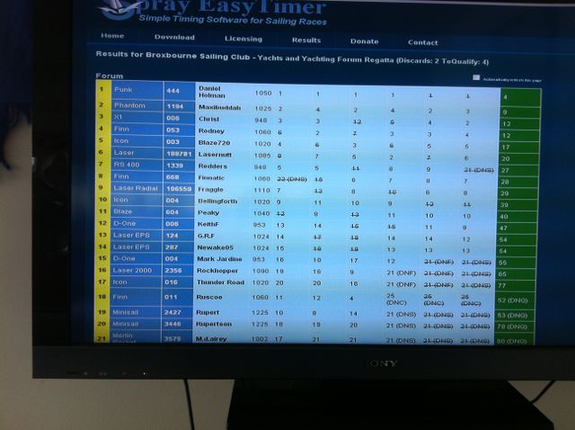

And the clubs are full of what? Members, members who have just had their key asset devalued by the 'experimental' actions of this bloody PYAG. So here, right now as Commodore of one of those so called clubs you are providing a service for, with all due respect, you are not doing a very good job, certainly not for us coastal clubs, bring your very best down here put them in an Icon and our Merlin sailors will run rings round them, the very moment they raise their kite. Honestly 1020 - 1010 - reasonable, 1020 - 1000 even, harsh but could be explained, 1020 to 969 smacks of a vendetta. I wonder, has anybody on that committee even looked at an Icon, never mind raced against one. Here anyone remember this, three icons raced against quite a few of us many of whom were quite well matched helms and across light to medium winds, inland, I didn't notice Icons having it away at 1020.. ![]() Edited by iGRF - 09 Apr 14 at 9:06am |
