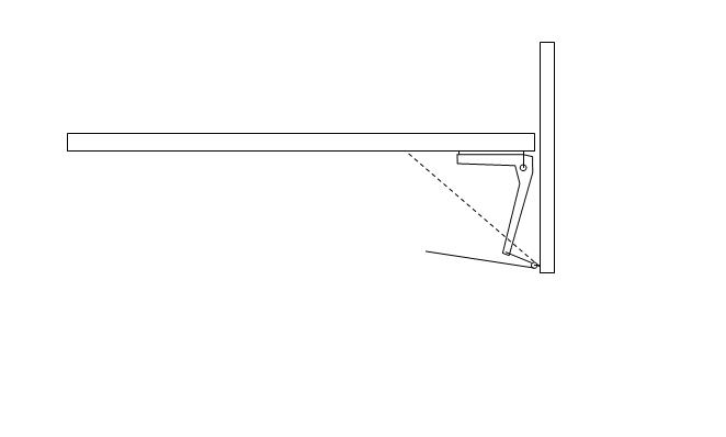

Originally posted by Rupert
Has anyone built an L shaped boom, with the gooseneck at the corner of the L, and the angle such that the short bit of the L comes out from the mast enough to allow travel? You pull the lever end towards the mast, the rest of the boom goes down.
Like this?
Like this?
Kind of like that - same end effect, but I was picturing the whole thing built as one monocoque structure, rather than the vang added on.

the above drawing of an anchored boomerand is basically a
temple vang
i think "dan's boat" another cherub has the monocoque L
shape
