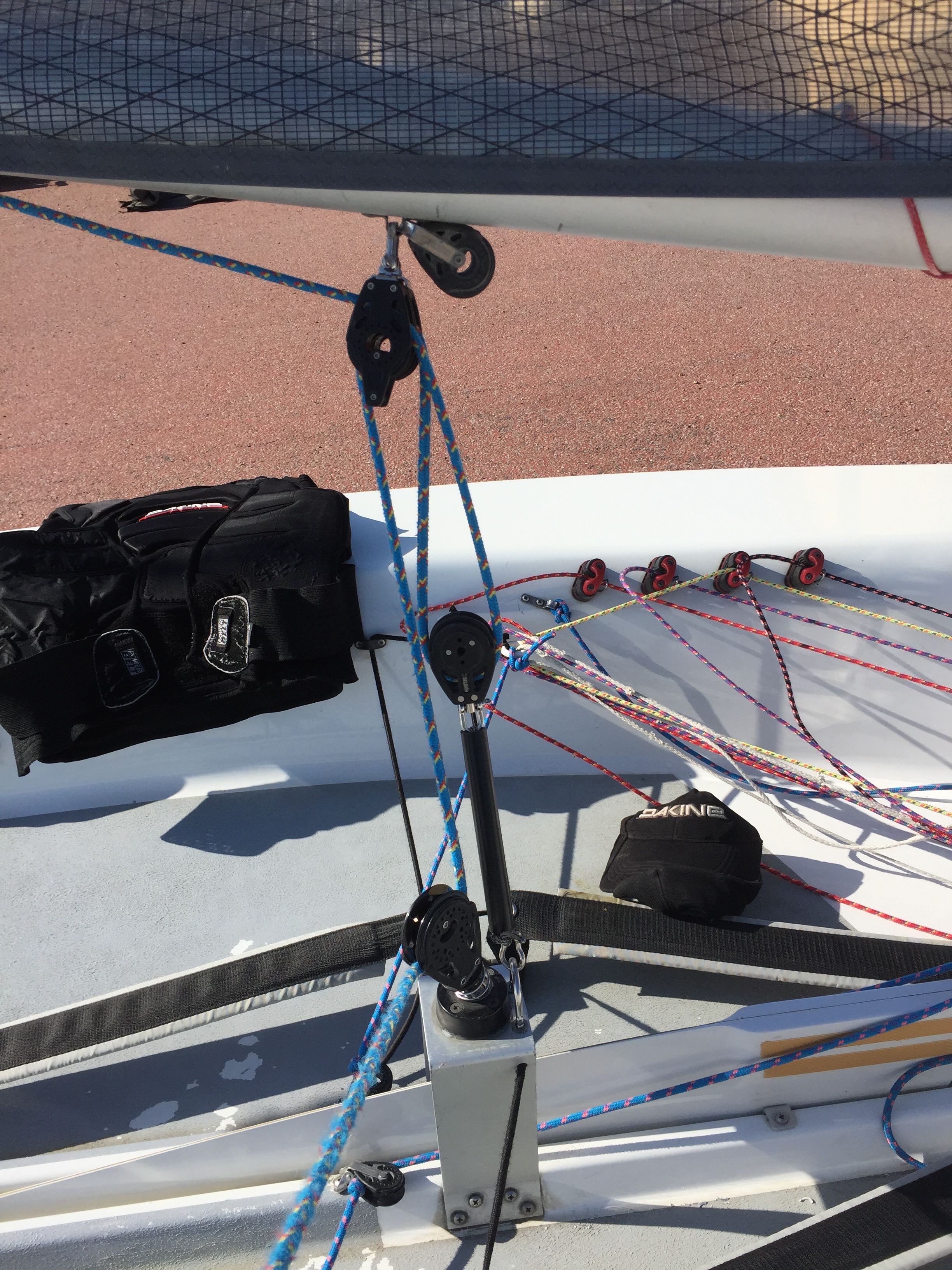

Latest update, I'm now totally centre sheeted and convinced it's the only way, having had a go in a laser and been absolutely trashed, then stepping back into the Solution and twice now leaving the mackerel fleet in its wake, with a 1st and a 3rd now against the coastal hot shots at Hythe, the 1st in light conditions and the third in a gloopy force three, in which I couldn't quite hold them off nor hold my chum in his phantom.
But for aggressive off wind wave action grabbing the entire bunch of sheet control rope and hauling at the right moment pays more dividends than a rear sheeted haul in and running by the lee with less sheet weight in light conditions it's also a bonus, so its goodbye rear sheeting from me for ever in this boat.

Hi, do you have any photos of your centre sheeting set up? I'd be keen to try it on mine. Thanks.

This was the set up when I still had one purchase back to the rear bridle, I have simply taken that purchase back to the tower.

Thanks, i'll give it a try.

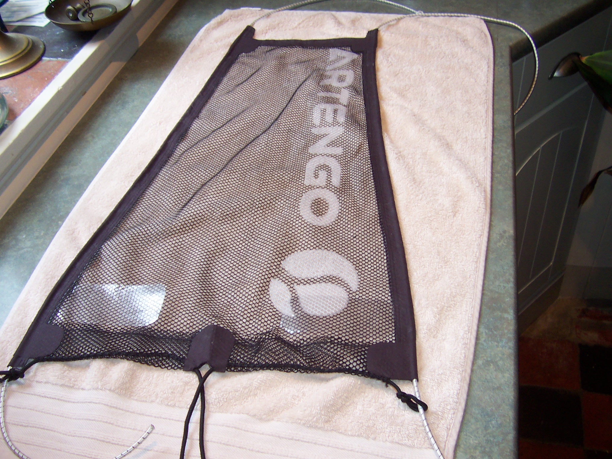

I got so fed up losing my mainsheet down the centreboard slot - hilarious consequences - that I made this slot cover. It started life as a tennis ball carrier, £3 from Decathlon. The edges are iron-on fabric tape, machine and hand stitched into place. The clear plastic patches will go behind the centreboard uphaul blocks. In the photo, the cover is laying flat, so you need to imagine it folded in half lengthways. The wider end will go behind the mainsheet turret, with the black drawcord around the sheet ratchet block. The bungee at the wider end is going to be fixed to the screws at the bottom of the turret. The bungee at the narrower end will be at the rear of the slot, running along the cockpit floor and tied to the rear toestrap anchor point. That's the theory. I'm sure the forward end will be secure, but I'm not confident about the aft end. I'll take some more photos when it's on the boat.

Steve it looks like something you'd hold your sandwiches in

Yes,yes, all right... Actually, you've given me an idea. maybe I'll stitch a patch pocket to it - somewhere to keep sarnies, course board, spare shackles,,,

Good idea, handy place to store stuff like that, we need cupholders as well as a carbon rig to bring us right up to date, then it really would be the perfect boat. Wink
