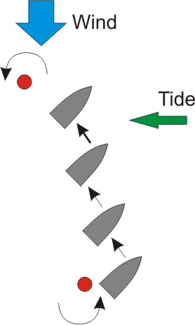

Surely this should be beat set uptide (looking up the beat)? If the windward mark was downtide then you would just sail on the tack that lets you crab across to the mark.......or am I not understanding Gordon's comment?? |
....down tide.... in the direction the tide is going. Here's a rough and ready doodle (They boat going for the right hand mark has cheated and gone the wrong side of the mark.....there is a protest going in
gordon ![]() Really should get out more ![]() Joined: 07 Sep 04 Online Status: Offline Posts: 1037 |
That's right, and 2nd leeward mark should be further downtide of 1st leeward mark.
Gordon |
Gordon
Grief yes, That's never occurred to me before... It means, effectively, its impossible to set a true Windward/Leeward course in cross tide... In order to get a true beat *and* a true run you'd need to have a triangular course with a spreader mark at the windward mark which would give an uptide leg long enough to cancel out the downtide drift during the run in order to set a true run... Failing that the interesting question is whether its better for the beat or the run to be one sided. In a handicap class I'd say its more important for the run to be true! |
Barty ![]() Far too distracted from work ![]() ![]() Joined: 16 Mar 04 Location: Scotland Online Status: Offline Posts: 240 |
I assumed you were talking about a port handed course not s'bd. In your sketch, realistically the right boat would drop down to the left with the tide and be on the left hand windward mark in one tack. If the windward mark is up tide they would not be able to get to it without tacking.....does that make sense? Edited by Barty |
No it doesn't make sense because they could just bear off and go stright into the tide...doh
