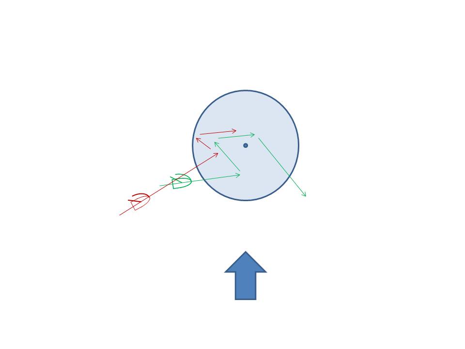

Unfortunately for damp freddie judges apply the rules as written not as damp freddie wishes they were written!
Rules 16 and 18.4 give no rights to a keep clear boat - they impose limitations on a right of way boat. There is an order of precedence in Part 2 of the rules: Rules of Section A ALWAYS apply and they define which boat is keep clear boat Rules of Section B impose limitations on the action of the right of way boat Rules of Section C imposes limitations on the action of a right of way boat at marks and obstructions, and may give limited entitlemnents and exonerations to a keep clear boat The key thing to remember is that having mark room on its own only entitles you to a very limited corridor to sail to the mark. You can only do a tactical rounding at a mark (wide in tight out) in the presence of other boats IF you are right of away boat. However ROW way boat must still (until they are at the mark) comply with rules 15, 16 17 and 18.4. A tactical rounding is not necessarily "good sailing" - it is "good racing" - which is far from being the same thing. 18.4 only applies in limited circumstances - limiting the rights of an inside overlapped right of way boat. 18.4 ceases to apply when boat ceases to have right of way and 18.2a or b applies. Gordon |

Bingo S4Life. the protest committee sided with me. Port has no rights apart from 16.1 or if 18.4 is broken. To answer JimC: the case shows an overlap situation, while of course a STB boat clear ahead would also be able to do this with port boats behind giving her mark room if they piled in faster on top of her. This case shows exactly my concerns, but also that the rules are in order of precedence where not modified to give exclusions: My points are: 1) ambiguity is caused by an oversimplification of the definition of "mark room" and the mix of 10,11 and 16.1 into 18/18.4: the definition "mark room" should have "her proper course while still within the zone" instead of "sail to the mark" IMHO. 2) people should be able to sail reasonably wide in, tight out at the LM : this is what we all expect to happen , this is good sailing: a gybe is already accounted for in 18.4. and so should a "Proper course" rounding before and at the mark 3) coming in on starboard to a port fleet is still a killer tactic! |

Agreed - mark room is the space ( a direct corridor) needed to sail from point of entry to zone to a position close to and alongside the mark on the requiired side. A keep clear boat entitled to mark room must sail along this corridor. A boat with right of way is not required to remain within that corridor but must comply with other rules (15, 16, 17, 18.4 may apply).
If you open out the angles so that boats are broad reaching into mark on opposite gybes then 18.4 becomes important. There is a limit to how far S may sail before gybing. If when she gybes she is no longer ROW boat then she must then sail directly to a position close to and alongside the mark on the required side Incidentally, in the the ISAF Case Book boats have kites. Gordon |

Tack the noun, when used with port or starboard,is defined in the rules. Other uses of the word tack, as a noun or as a verb are not defined (which is why rule 13 is written the way it is). Therefore the dictionary definition applies.
Therefore, the expression "room to tack" which only applies to a windward inside overlapped boat does not include a room to gybe. Similarily in rule 20 room to tack only applies to boats sailing close hauled or higher. There is a definition of gybing in the rules - but only for match racing - C.2.4. Rule 15 deals with most situations where a boat changes tack by gybing and thus gains righ of way. Gordon |

as another example of where the rules could be clearer, the rules do not define what a 'gybe' is, and so given: 'Tack, Starboard or Port A boat is on the tack, starboard or port, corresponding to her windward side.' and Mark-Room Room for a boat to sail to the mark, and then room to sail her proper course while at the mark. However, mark-room does not include room to tack unless the boat is overlapped to windward and on the inside of the boat required to give mark-room.' it is not actually clear if '...room to tack' includes room to change tack by gybing. The problem is that Tack is defined as an adjective but seems also to be used in the rules as a verb.

I agree with the good advice given by Gordon above. I also think damp_freddie is seeking to sail in a way that would at best only give a very marginal benefit but which in practice might not actually be beneficial or successful on the water. Having said that, I would make an observation that the current rules do not describe sufficiently well what is meant by 'sail to the mark' - as is evidenced by this debate, by the apparent need to clarify the requirement to sail 'straight' to the mark 'in a narrow corridor', and by other similar conversations I have heard at my club. |
No, No, No. You're confusing yourself again... The crucial point you seem to be struggling with is the difference between a boat with right of way and a boat which is simply entitled to room. If you have right of way you can pretty much sail where you like given certain limitations, principly those to boats that are entitled to room. If you are entitled to room, but are otherwise the give way boat then all you can do is sail to whatever place you are entitled to room to get to. Room is not the same as right of way. A boat clear ahead almost certainly has right of way. An inside overlap boat may or may not have right of way, depending on circumstances. If its on port and the other boat is on starboard the inside boat does not have right of way for instance, but if the inside boat is on starboard and the outside boat is on port then the inside boat has right of way. |
