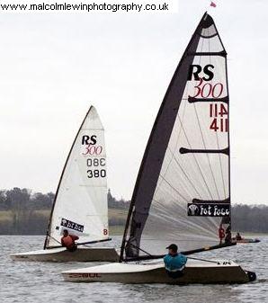

Originally posted by Steve411
sbolland by you.
Another well-engineered unstayed rig. The main thing is that kicker tension is the key sail control as kicker tension, mast bend, sail fullness and leech tension are inextricably linked. You can't have a tight leech for pointing without flattening the sail off for example.
Downwing the unstayed rig makes life interesting as gusts bend the mast forward making nosedives more likely. Unlike stayed masts we use kicker tension to depower downwind (bend the mast and therefore flatten the sail) whereas it's more normal with a stayed rig to blow the kicker downwind (on boats with kites at least) to depower.
Pic by www.malcolmlewinphotography.co.uk
OK, here's the pic!
Steve B
RS300 411
RS300 page
