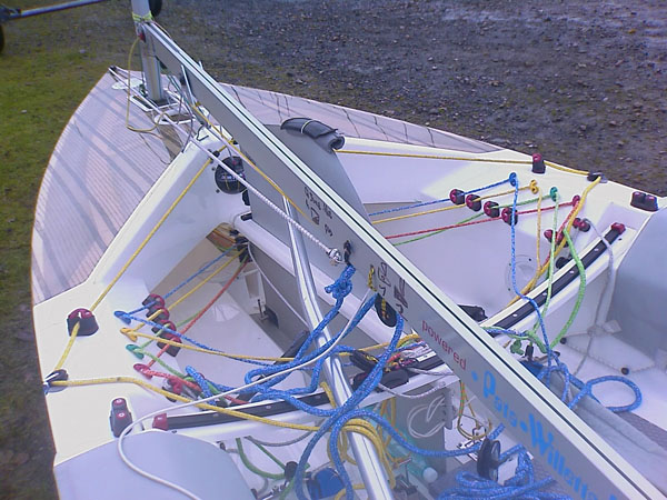

I too am a big fan of the temple vang. Nice and simple, more room for the crew, and all the purchases can be hidden up the side of the centreboard case. However I could only really see it being light, strong and practical on a carbon boom, I guess you could weld one up in alloy but I would not give it long and it will probably weigh a ton. If made in carbon, it must be done right, as in VERY strong, and at just the correct angle, as it's easy to get it wrong and go "block to block", especially if you have a raking rig. You can just see one here on this 12. The white part of the mast up to goosneck height is not mast, it's actually part of the hull, it's called a stump and it's completley devoid of any support such as lowers, and has not broken yet despite our best crashing efforts! The vertical member near the gooseneck is in massive compression and the member sloping back is in tension although obviously does not have to be as strong as long as it's well attached to the boom. Edited by Iain C |

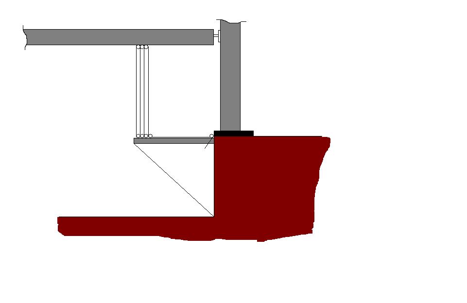

Graeme, get rid of the hoop, as you say if you have a bridled mainsheet onto the transom which is then led along the boom and down into the cockpit there is no need for a hoop.
Regarding the scorpion kickers system I mentioned previously I cant find any photos but here is a sketch (sorry for the lack of artistry its an MS Paint special), effectively a temple vang mounted from the foredeck rather than the boom. wire from prodder to cockpit sole/bulkhead junction ensures that prodder sees no bending only compression. THe prodder is only pinned to the back of the foredeck to allow it to rotate laterally with the boom. ![]() Edited by craiggo |
