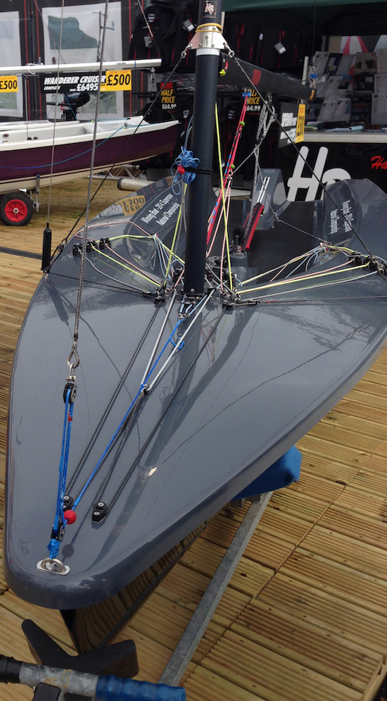

The modern Applecore has adjustustable shrouds and jib tension but gets away without lowers by having a hog stepped mast with an adjustable ram at deck level. Add leading back the forestay to pull the mast forward again and there can be an awful lot to do at those marks even for two crew and ensuring you get the same settings twice is probably the hardest bit.  Smile
