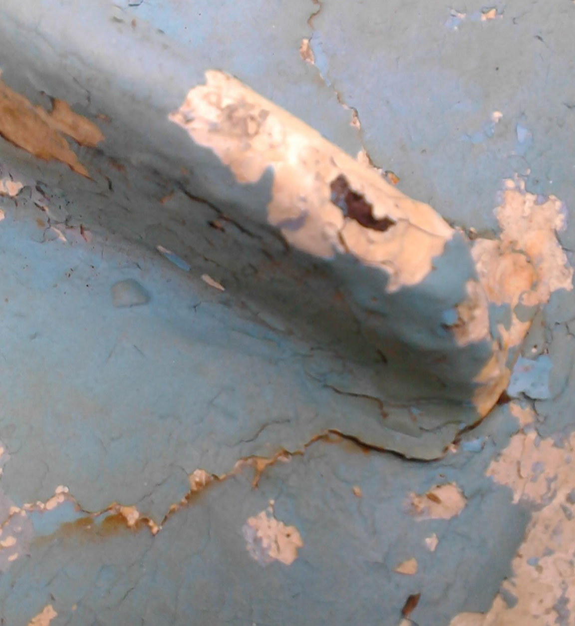

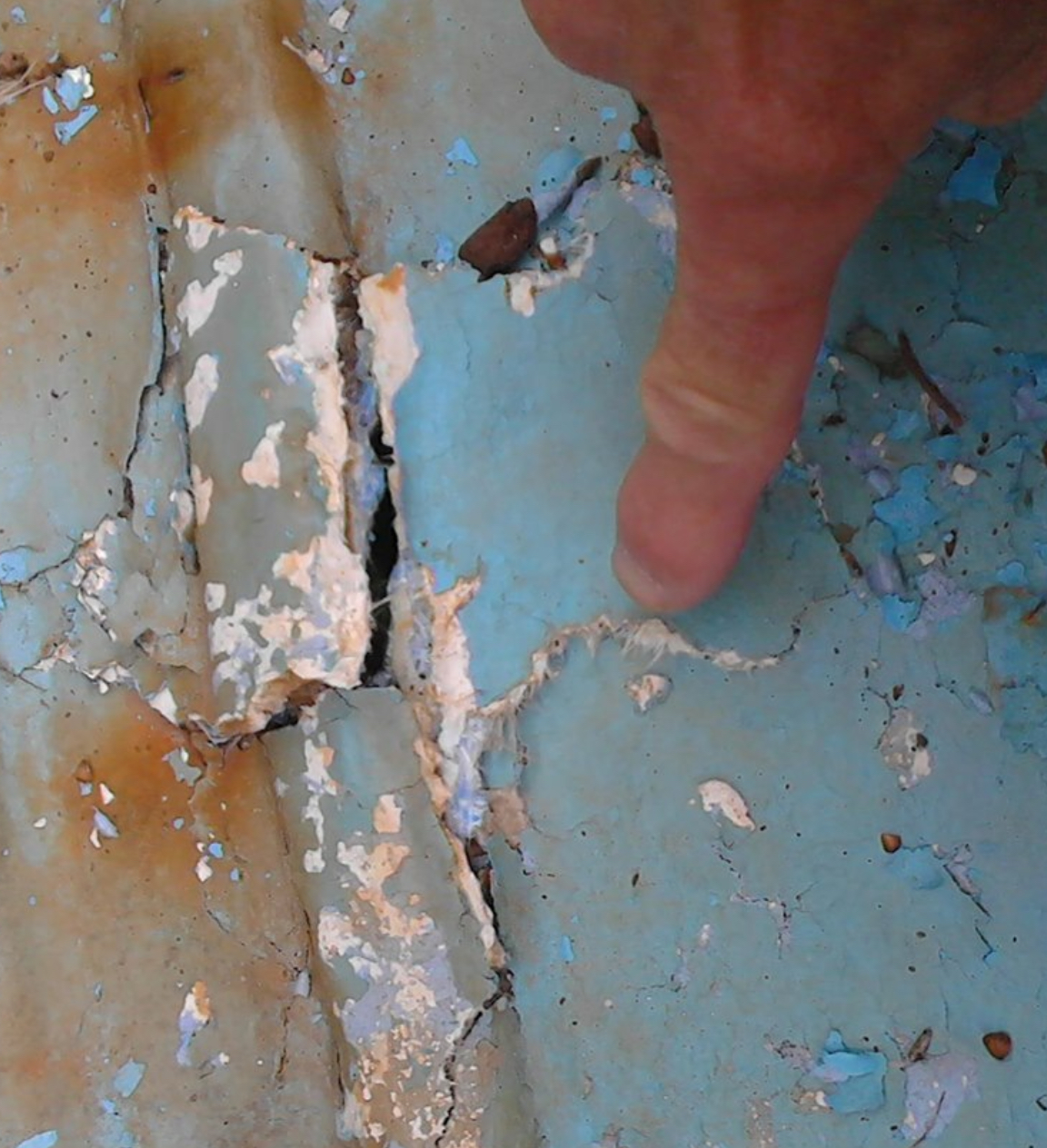

Your logic is Flawless Sam Spoons. I think once I have moved it is a case of seeing what comes up. I repaired a holed West 11 once and was shocked how flexible the panels were and so by extension how hard it is to make flat GRP panels stiff when you have to get down to the weight of the original wood design.
Back up at the club with the abandoned Ent as per the picture and will have a good look at it

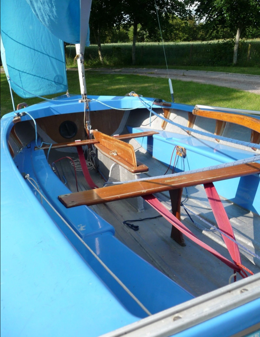

That Ent' looks nothing like mine, the Thwart on mine is across centre board case, can see why there was flexing with this layout, I suppose you could move it ? There are no bits of wood under side decks either, never seen this particular layout.

I can't recall ever seeing an Ent with the front thwart crossing the CB case (wouldn't that be out of class? I've seen them with it at the extreme front of the case on a FRP boat), pics please 432zero Thumbs Up, and all Ents baring the Rondar Mk3 have knees supporting the side deck, they are GRP on some GRP/FRP boats but they are always there.

I presume that 432zero is talking about the the Ent in the OP, i.e. this one,
It doesn’t look like any of the other Ents I have seen either. Whether wood, GRP or FRP most generally look very similar layout wise save for with tanks or airbags.

Ah, yes, I'd forgotten the old Holt GRP WRT the 'knees' under the side decks. But the thwart is still bifurcated by the CB case and board. There is obviously some flexibility in the positioning of the thwart(s), the internal layout used to be strictly to plan and pretty much as in the one above but I've seen them at the extreme front end of the CB case and the after thwart is absent on the Rondar mk3.

That's the boat, wooden layout different on mine the 2 thwarts are both fixed to centre board case, centre/aft front block was attached to back block.
Perhaps it's a regional thing but I have only seen Ent's with same layout has mine, wooden boats excepted.

It looks like it would be where the crew sit and they would have to straddle it, tacking must be a proper dance. Can’t see it being much use as a stiffener, it being cut in half and all. Clearly it wasn’t a brilliant idea as it has become extinct.
