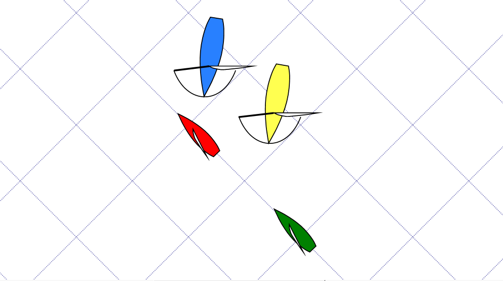

Originally posted by flaming
Thank you Presuming Ed for the Diagram, that was exactly right.
I'm glad I'm not the only one finding this one a bit of a brain pain.
As you may have guessed I was one of the spinnaker boats, yellow to be precise.  The situation developed faster than I, or I think the helm of the other boat, (which are both circa 40 foot yachts) appreciated.  I was concentrating on passing ahead of green, and only really became aware that there was a problem with the size of the gap when blue came closer than I was comfortable with hailing that they would need room to pass astern of red.  At this point I don't think it would have been possible for us to get behind green (where there was room in this case) in anything approaching a seamanlike way.  So we did both go through the gap, uncomfortably close together, which didn't endear us to green....  However the protest time limit has passed, seemingly without green wanting to spend time and effort in a complicated protest with two boats from a different class.  Can't say I overly blame him for that.  I am left wondering what would have happened in a protest though.
So this was really one of those that I was trying to dissect afterwards, as opposed to being fully aware in the build up and making an active call.  But hopefully with an idea as to what to do if the situation occurs again, which is possible given the nature of solent racing.  So far though everyone seems as stumped as I am!
There does seem, in general, to be a small problem with the rules when different "room" situations conflict.  See my previous effort here.  http://www.yachtsandyachting.com/forum/forum_posts.asp?TID=11141&title=which-takes-precedence-18-or-19

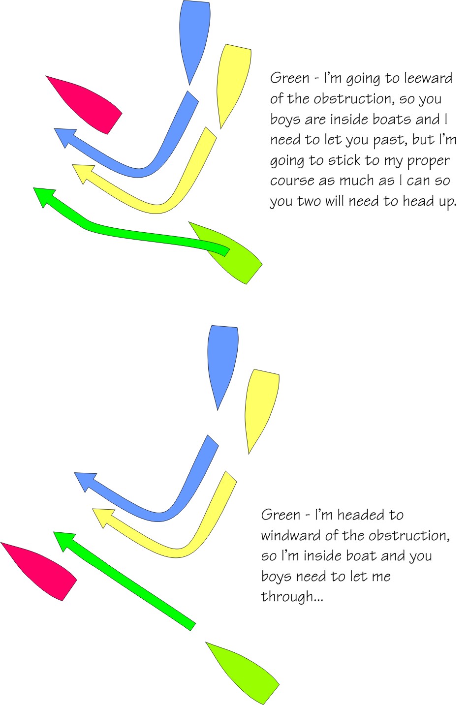

My thinking was that
19.2b says, paraphrased, that if it were never possible for you to give room you needn't.
14a says, paraphrased, that if you can't avoid contact once its obvious the other boat is going to break a rule then you get exonerated.
18.2e says, paraphrased, if you can't give room to an inside boat you needn't
So there's a thread going through section B/C that in various circumstances if it is absolutely not possible for a ROW boat to give room then she is not required to.
But what do you make of the thought that as red is clear ahead of green, and therefore an obstruction to her as well as to blue and yellow, then as blue and yellow are overlapped with green then green is required to give blue and yellow room to pass the obstruction, but, presumably, not room to sail the course they would like?
Do you end up with something like this?
Edited by JimC - 06 Oct 15 at 7:40pm
sargesail View Drop Down
Joined: 14 Jan 06
Posts: 1459
Post Options Post Options   Quote sargesail Quote  Post ReplyReply Direct Link To This Post Posted: 06 Oct 15 at 11:42pm
Jim,
There's certainly a logic too that.
What I take away though is that if I were ever faced with a situation like this I would need to act early:
It's classic anticipation stuff.
Take blue ahead of red.  Or if blue became overlapped from clear astern take blue up and then bear away to break the overlap.  Yellow could also try and create a situation where blue can't get ahead of green because of the angle of approach, and has to follwo yellow into a gybe.
