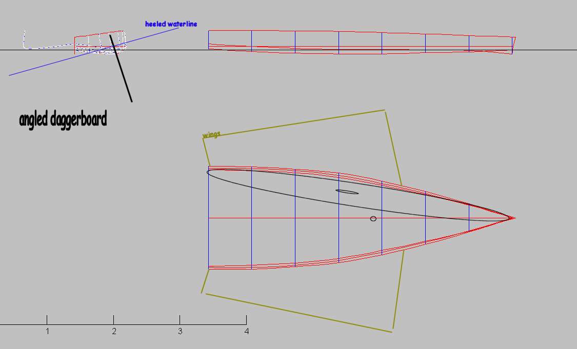

Scow moth?
You could sail with the boat heeled to give the narrow waterline along the leeward chine ... loads of righting moment, and mega stable offwind.
Anyone remember Tenspar rigs? Have the rig on a space frame that can be pulled up to windward, like a windsurfer (you have to love the idea Greame). And wait for it ... how about leeboards? Proven ditch concept that kicks up as per the brief, easy to play around and experiment with. |
Happily living in the past
Might be some technology that you could borrow from inflatable SUP's, howabout being able to change the underwater shape using inflatable bladders, you could have a nice round low drag displacement shape for light winds using a central bladder, then inflate the outboard bladders for more righting moment in a breeze. You read it here first ... in a Peter Chilvers sort of way!
