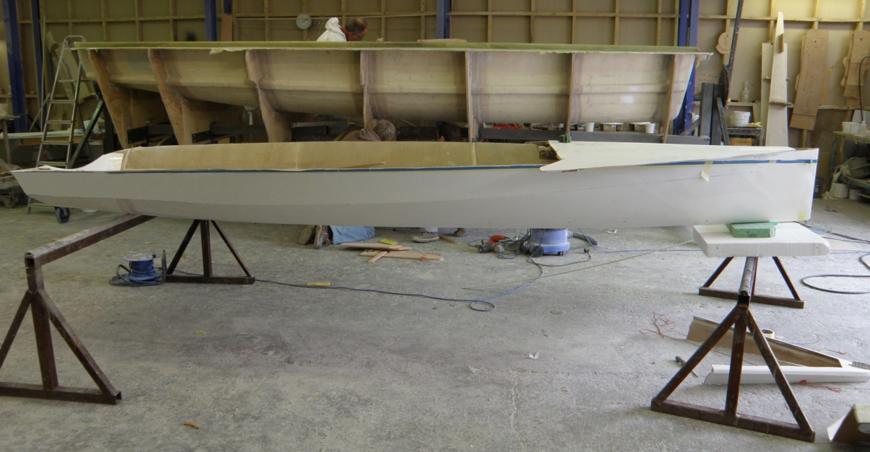

"Echo Prototype"? What does that do then?
Hi Toby ...
Not sure if I sent you this one in the Summer... Can you guess what it might become yet ? (I think you can) Don't get too excited - It is just a bit of a diversion for me through the winter to try a few new ideas but you are welcome to have a look... its very very light though ... (the one in the foreground that is !) Mike L ![]() Edited by blaze720 - 31 Oct 13 at 4:06pm |
