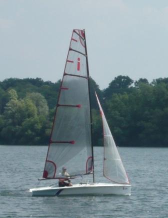

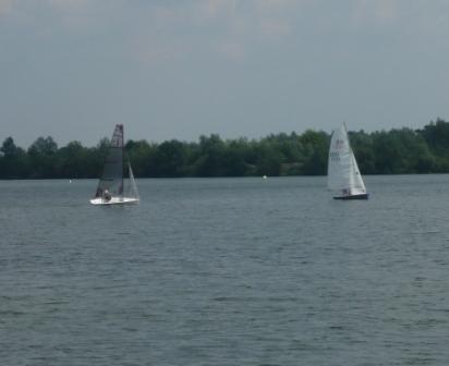

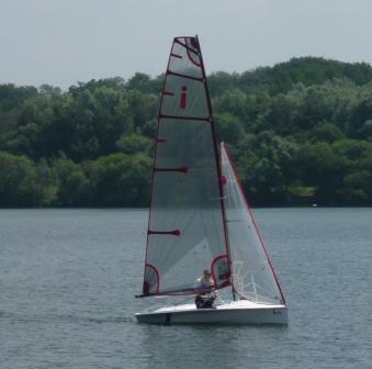

Hi folks. I went to try out the latest development in the ICON rig today. Snapped some photo's and shot a very short video. As you can see from the vid, it is pretty quick! The weather was glorious but the wind a little fickle. It is a narrow diameter carbon stick (non rotating) with a bigger main. It is a semi-fully battned main, which is a lot easier to read than the fully battened one and still very lightly loaded on a 2:1 sheet. The boat was very easy to sail and so smooth to sail. The reduction in top weight from fewer battens and the lighter mast were quite noticable compared to my standard NS14 rig. The extra sail area (and soft sail?) also made it significantly faster on a broad reach, and I have to admit, tacking is easier with a fixed mast. It is still a development sail, so I believe the boom will be raised slightly, and the leech shortened to lift the outboard end (currently the boom droops a little). It was also too flat in the head, but that's easily fixed. I know I'm biased, but I believe this is going to turn out to be a very special boat indeed, and I can't wait to get mine! Interesting comparison to 400 rig: |
