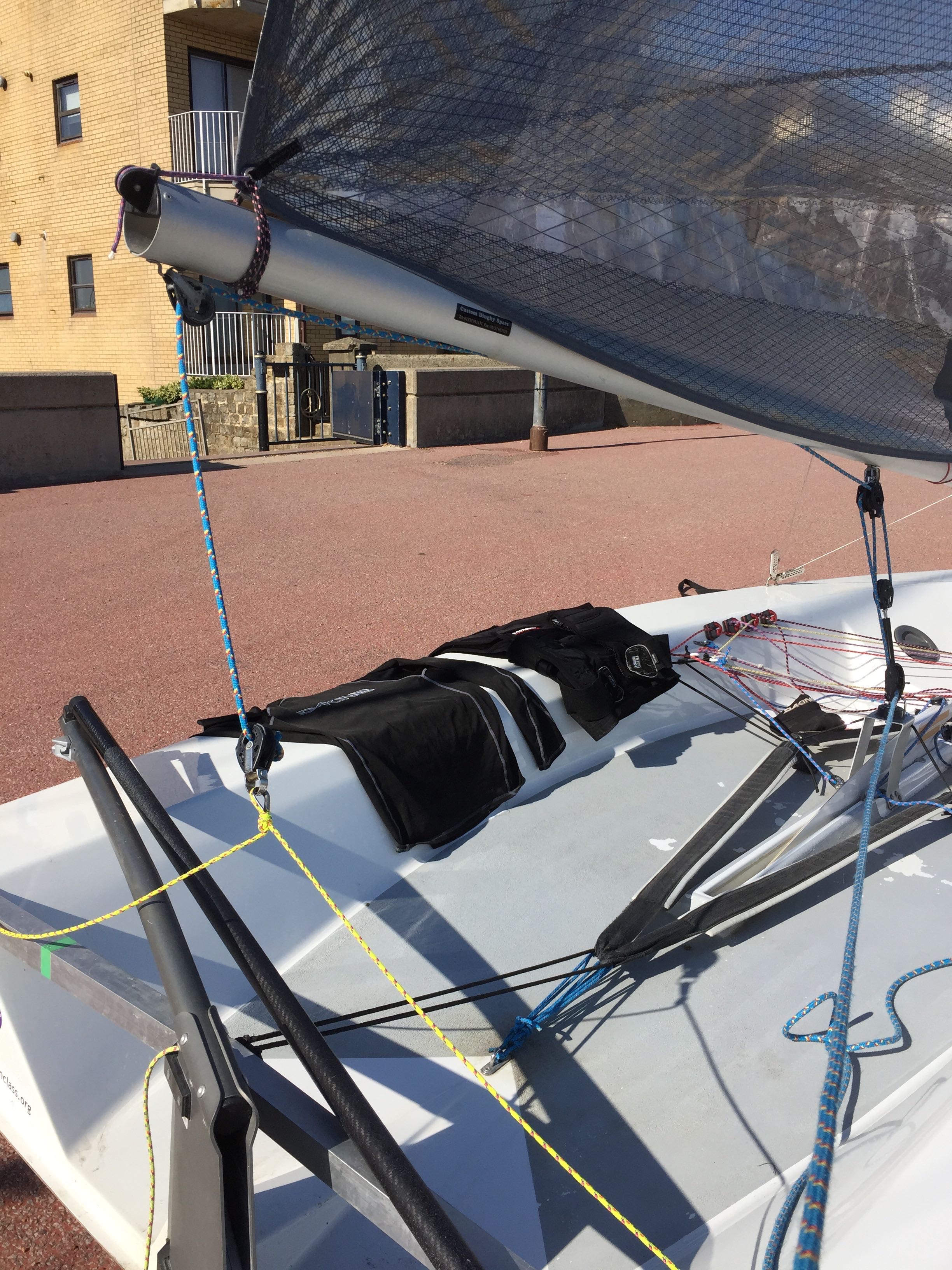

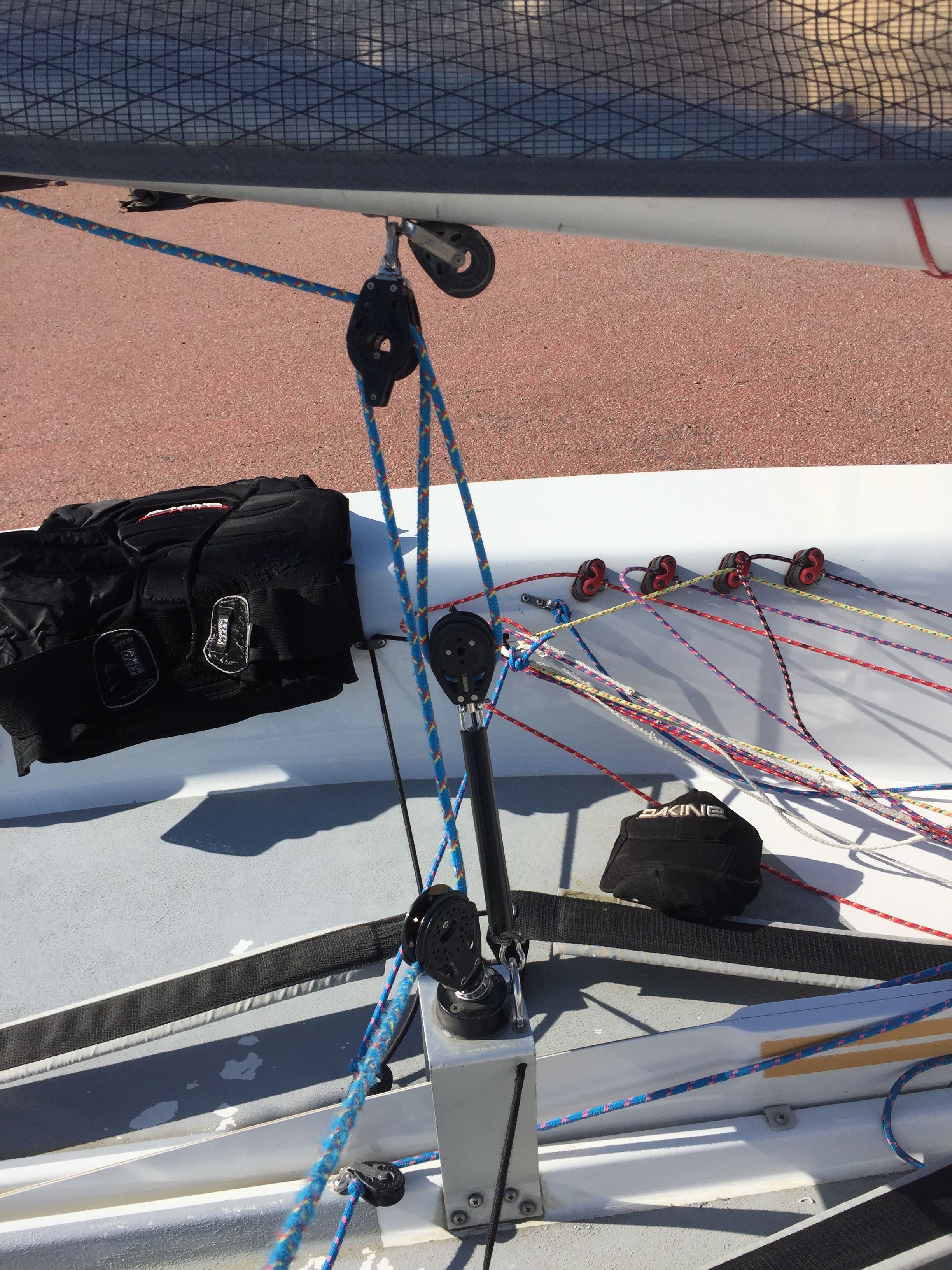

Agree, nearly did that yesterday, but one thing at a time. Rigged this arrangement that worked just fine, it's just the rear bridle that keeps engaging with the stern quarter when you don't need it to. ![]() I've used a bit of tube from a kite safety release so when it swings across there is no way it can engage the mainsheet block, it just needs a loose guide for the single main sheet to travel in to make it 100% perfect, although it caused me absolutely no grief in last nights race. This rear bridle on the other hand has got to go. ![]() |

Graham, I'd look at tying a couple of bits of elastic from the centre of the bridle to the corners of the boat where the rope is tied to. That will take up the slack and mean the bridle shouldn't get caught round the corner I would have thought. I'd also consider having 2:1 at the rear, and then putting the ratchet block at the front mainsheet fixing point half way along the boom and sheet directly from the boom. Its so much nicer than deck mounted and does away with the 4 million blocks at the front of the boat uncluttering everything. Plenty of purchase.
