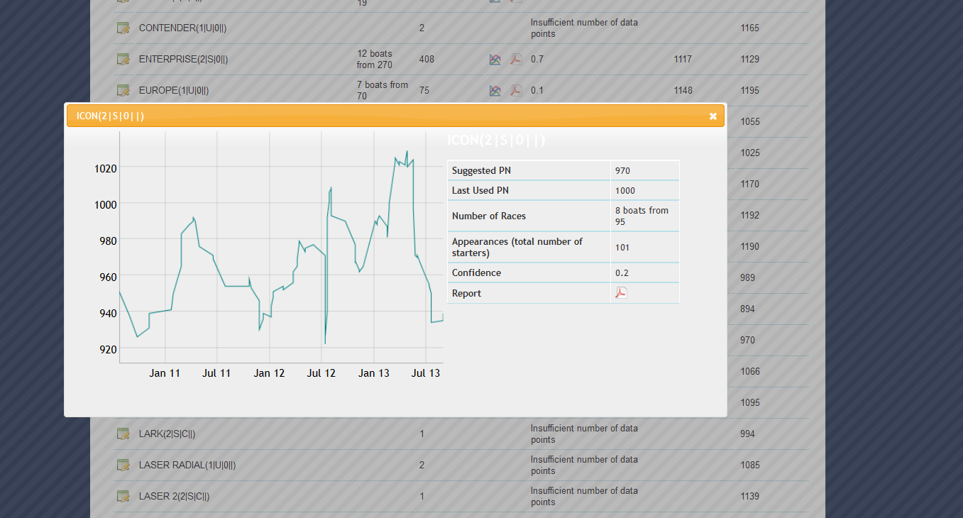

If you want numbers then this is the graph from the ICON stats submitted to PYS at Burghfield. Whilst I recognise that they have a low reliability value of 0.2 and that it does not take into account more than 8 different helms who have borrowed the boat the facts are still there. I suspect that they are still on the low side but think that sub 1000 is not unrealistic.
It is laughable to me that when you first suggested the of 1020 you were adamant that it was not really any faster than the Tazar, yet now you back track and blame it on Peaky claiming it was never your idea at all.The arguments we had at Sailing committee meetings over that make me realise that any statistics can be bent to anyones benfit.
Needless to say , you wanted some fact,well that chart below probably helps explain why the number is where it is at present.

Jeremy, what is that thing and how does it work? Not that I feel a place like Burghfield should set any trend at all, but it does precisely make my point that the wrong people are influencing this, how can a boat like that now have a fair race with a trapezed hull like the RS500 on open water? Can you sail a tack for more than two minutes in any direction at Burghfield without having to change direction? Do you even have trapeze boats racing there?
I had a genuine interest in that boat, have gone to great lengths to get a demo set up for my club members here at Hythe, so what do I tell them now? Oh forget it a bunch of guys on a lake near Reading have decided it's faster than the other boat with any numbers at our club, the 500.
Whatever generated that plot, is f**ked up, plain and simple, bin it.
