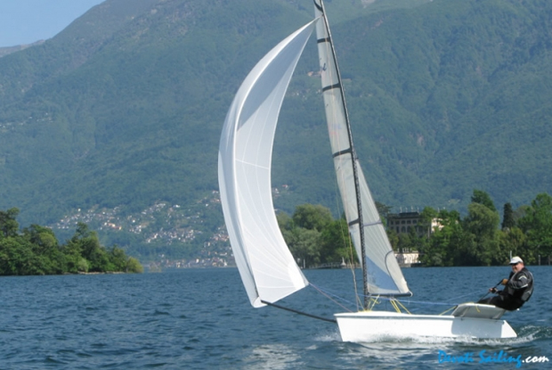

It's doesn't look that windy to me... but I understood from Luca/Rodney that this is designed to flex like this:
Deffo needs more mainsheet tension for sure that puts the right shape into the mast.
It is designed to flex off like that to create a nice slot for the kite, however the windier it gets you need to trim the mainsheet for best angle and then apply kicker to give it the correct twist uptop.
I think this picture was a demo in Switzerland.

....case in point....nice picture but mainsheet not in far enough to get good speed, and for sure if you took the picture from another angle you would see the mast bending.
Post Options Post Options   Quote Guests Quote  Post ReplyReply Direct Link To This Post Posted: 24 Jun 10 at 3:19pm
Cheers Tim.  Must be a quality bit of kit to take those loads unstayed!  Sounds like you use leech tension as a sort of backstay?  Best of luck in Torbole.

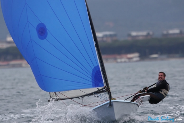

Fair enough Tim, I think it's quite common for unarig sailors to sail with the mainsail too far out when they first step foot in an asymmetric...
no further proof required than one of my first outings in the musto:
If you look at this dude in a D-One he's clearly pinning for speed; it looks a tad overpowered, but I bet it's still quick VMG:
That is true....700 sailors "learning the ropes" at our club do it and then they can't stand on the wings.
Sheet in, heat up and bear off.
