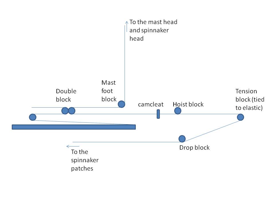

Linus,
I cant find a reasonable enough picture to explain it but it looks like you have the halyard rigged incorrectly. Its also a while since I last sailed in a BOSS so my memory as to where all the fittings are is a bit hazy. There should be a back to back block (two blocks connected to each other) under the front end of the spinnaker chute, which the pole outhaul runs through. The spinnaker halyard should go forward through this before coming back along the cockpit floor. The halyard should run through a camcleat and then there should be a pulley immediately behind it and you should pull up from behind the pulley, which will ensure that as you hoist the spinnaker automatically is jammed. I will try and draw a sketch and post it after I've eaten my dinner! |
![]() Linus, managed to do this before my dinner was ready. I hope it helps. |

http://www.google.co.uk/imgres?um=1&hl=en&safe=active&sa=N&tbm=isch&prmd=imvns&tbnid=hk-HuX8kPI5DXM:&imgrefurl=http://www.harken.com/onedesign/49er.php&docid=62NxXWQMbHKTQM&imgurl=http://www.harken.com/images/49er_spinnaker.gif&w=500&h=294&ei=IPDpT8KGIvPa0QW80biqAQ&zoom=1&iact=rc&dur=233&sig=112909604247397512777&page=1&tbnh=129&tbnw=220&start=0&ndsp=17&ved=1t:429,r:0,s:0,i:72&tx=138&ty=43&biw=1280&bih=685
if you follow the orange line shown here on a 49er diagram, it should be how your boat is rigged
Thats what I've just drawn, and I was only on the Harken site the other day! doh!

Craiggo you've my repect, somthing like that before dinner, great job!;) And to confirm the whole thing the post from themeaningof... thanks a lot!
Now I just need to know what I have and what I need to by! I'll do that tomorrow;) Thanks again! Linus |

![]() Am I right with my assumption that you pull the lace behind the hoist block to get the gennaker drawn? In that movement the “Double block” will move to the right until the gennaker pole is fully up. To get the gennaker back in you pull the lace the other way around, right behind the drop block. The pole gets in with the pull of the gennaker? |
Yes, that's right. You don't ever have any load running through the tension block, it's just there to try and reduce the amount that that the line gets tangled up.

Great, so theoretically everything is clear. Now i'd like to know something about the main parts! It would be great if you could tell me something about the options I have on:
- the hoist block - the drop block - the camcleat - the double block Tell me you're experience you've made, and may be where I could get the parts. There's also one very basic question I have, who is in charche to get the gennaker drawn? I mean the handling will do the one in front, for sure. Thanks for your answers & have a nice day Linus |
The CREW should pull the gennaker up and the CREW should pull the gennaker down. The HELM keeps steering - but can help a little by holding the gennaker sheet whilst the crew pulls it up, then the gennaker fills up with wind nice and fast .... and you're off.
As for blocks, any small blocks will do fine. for the Camcleat, you can use a spinlock (as the photo earlier in this thread), then you don't need a hoist block. Use a swivel block for the drop block then you can drop from anywhere in the boat. I use Allen 20mm blocks (http://www.allenbrothers.co.uk/item.asp?prod_id=1&cat_id=1) with a A2020 as the drop block and A2028 for the double block). My boat is smaller than yours tho and the kite only 13sqm compared to your 33sqm!!!! You might need bigger blocks. Enjoy
