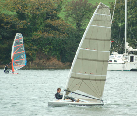

Whilst I don't contend that stayed mast are in any way inferior or less adjustable, may I suggest you do a bit of background research on the new Byte CII rig. It really is a feat of engineering, which is enormously adjustable, and acts effectively as a wing mast as is rotates in the mast foot. Now, a blank peice of paper with a unstayed shaped mast section designed to be controlled in the same manner as the Byte rig on a hull specifically designed for it......and if you can make it aimed at 70kg sailors.....that I would like to see. |
The paper was particularly blank. Prob more a 75- 80kg person's boat right now, but smaller and bigger versions of the rig in the pipeline... |

Another well-engineered unstayed rig. The main thing is that kicker tension is the key sail control as kicker tension, mast bend, sail fullness and leech tension are inextricably linked. You can't have a tight leech for pointing without flattening the sail off for example. Downwing the unstayed rig makes life interesting as gusts bend the mast forward making nosedives more likely. Unlike stayed masts we use kicker tension to depower downwind (bend the mast and therefore flatten the sail) whereas it's more normal with a stayed rig to blow the kicker downwind (on boats with kites at least) to depower. |
